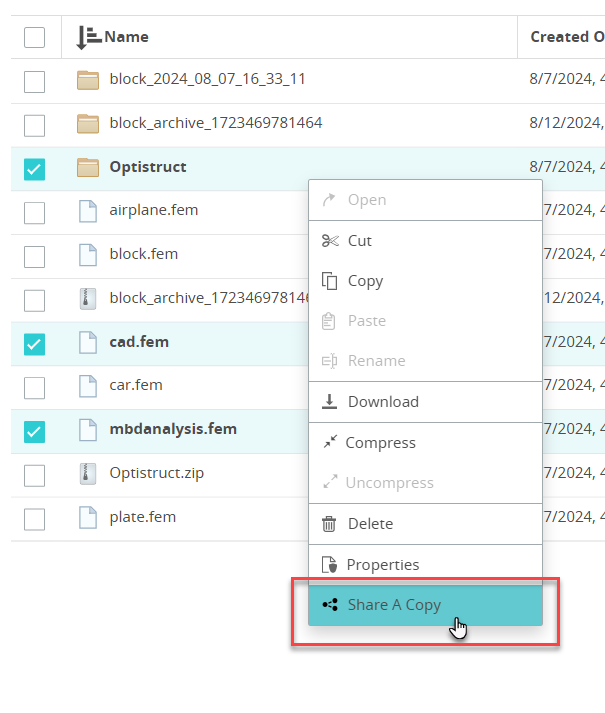

- Click the Files tab located in the upper left-hand of the page.
 - Using the file system tree on the left, navigate to the location where you have the files or folders.
                Right-click on the folder or files.
                Tip: You can select multiple files or folders. Select the first file by clicking its name and hold down CTRL and select each file by clicking its name.
                Select Share A Copy.
Figure 1. Share a Copy

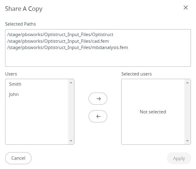

The Share a Copy dialog box is displayed.Figure 2. Share a Copy with Users
The Selected Paths displays the files or folders that is selected to share.

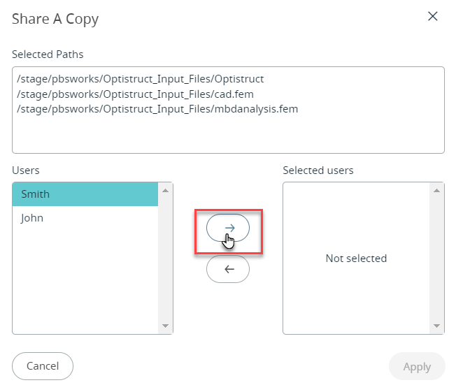

 - Select the user from the Users list.
                Click
                Figure 3. Share a Copy - User Selected

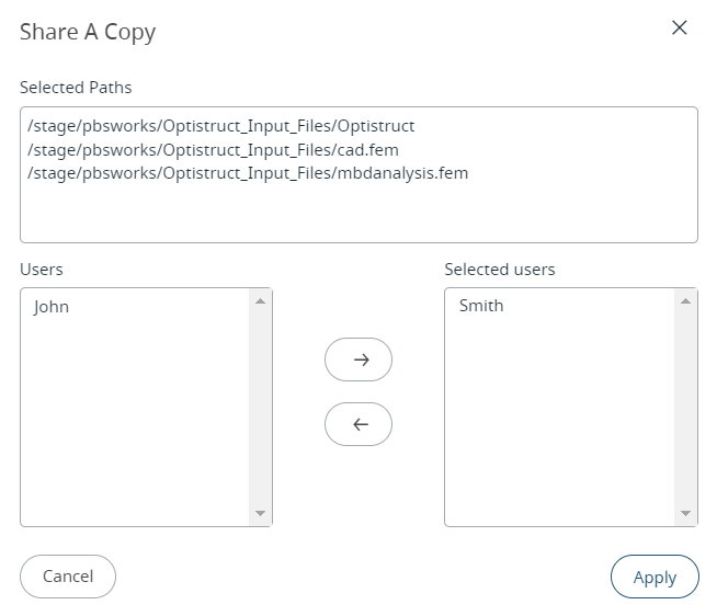

The user name gets displayed in the Selected Users list.Figure 4. Files and Folders Shared to User
Note: To unshare a copy of the files or folders from the user, select the user from the Selected Users list and click
                Click Apply.
                A notification will be displayed that you have shared a copy to the user.
Selected files/directories shared successfully.

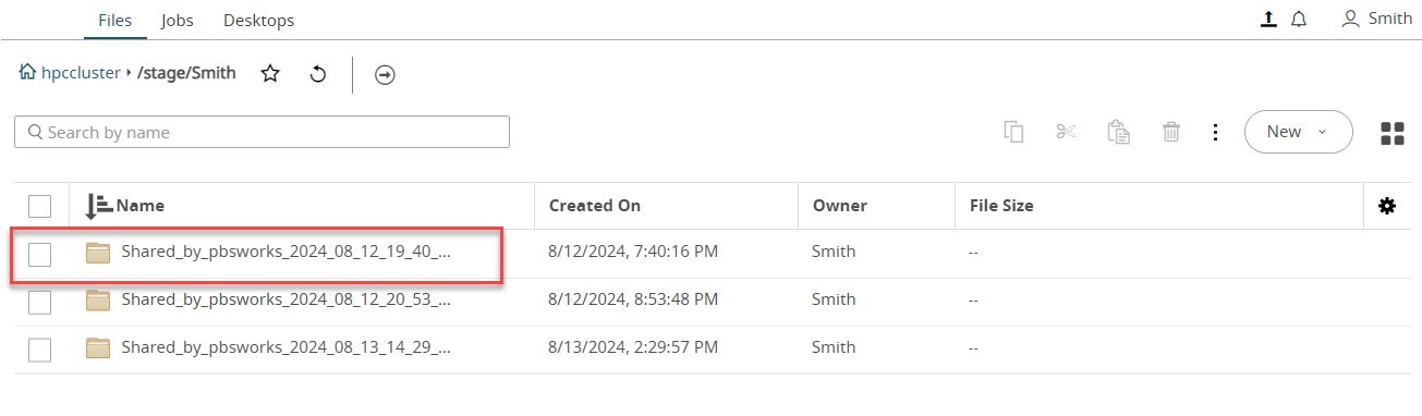

The user with whom you have shared a copy of the files and folders will view the details in the Files tab.Figure 5.
A folder Shared_by_<Username>_Timestamp will be created and shared copy of the files and folders will be stored.
