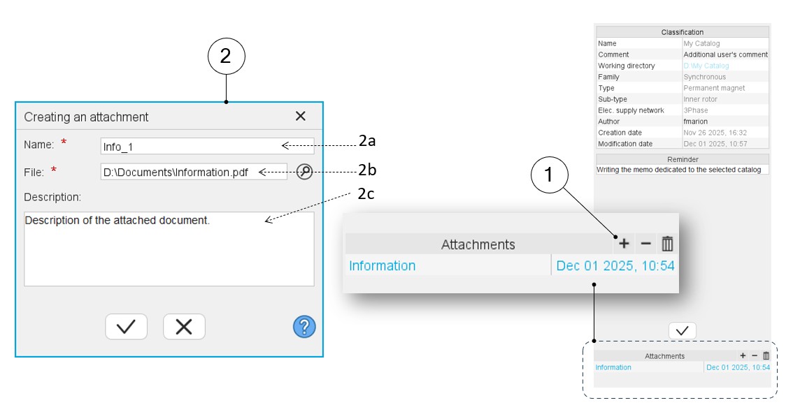

How to add an attachment?
Table 1. How to attach a document to a catalog in Motor Catalog?
1 Button (+) to add an attached document.
2 A dedicated dialog box allows adding a new attached document.
All kind of documents can be attached (like Word, Excel, PDF or text files, pictures etc.).
2a Give a name to the attached document.
2b Select the folder in which the document is stored to be attached.
2c It is possible to write a reminder dealing with the attached document.

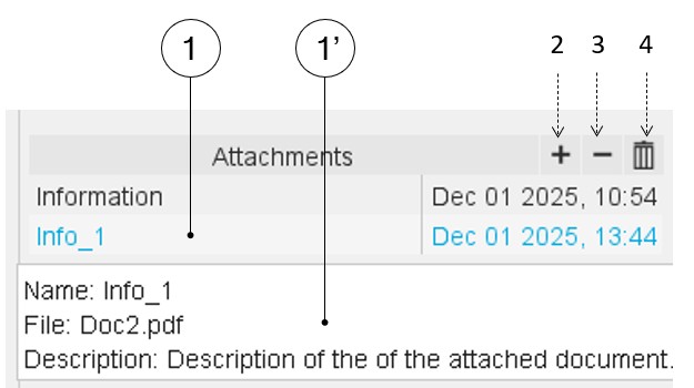

Management of attachments
Table 2. Management of attachments
1 Selection of an attached document.
Once selected, a tooltip (1’) reminds the name and the description of the selected document.
2 Button (+) to add an attachment.
3 Button (-) to remove one or several attachments.
4 Button for removing all the attached files.
