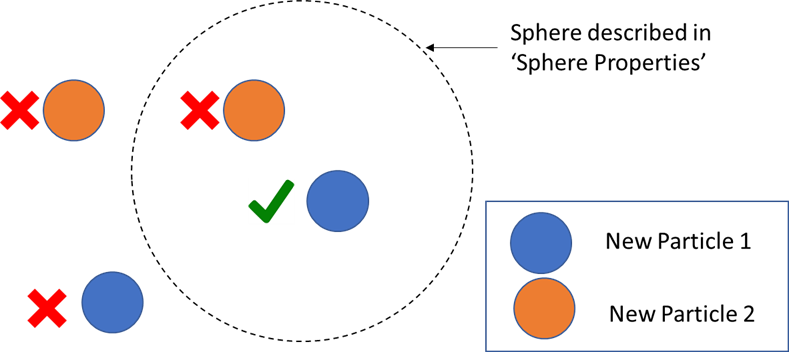

In this example, you are defining a sphere to track the Custom Residence Time.
Although the simulation includes an additional particle type (New Particle 2),
because it is not displayed in the Particles list in the dialog box, particles of
this type will not have a value added to their Custom Residence Time attribute,
unlike the particles of type New Particle 1.
In this example, the particle of type New Particle 1 inside the described sphere is
the only particle to meet both criteria. As a result, it is the only particle whose
Custom Residence Time value will be increased.
