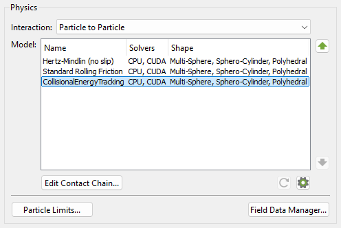

  2. In the Creator Tree, select Physics.
  3. Select Particle to Particle and/or Particle to Geometry from the Interaction dropdown list.

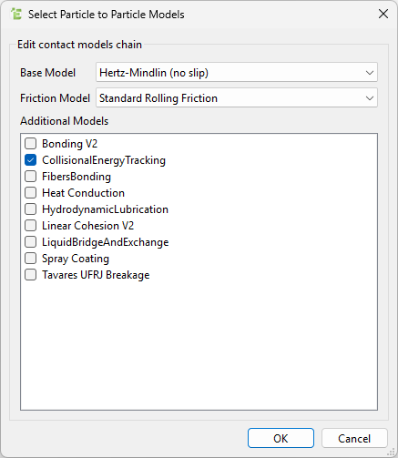

  4. Click Edit Contact Chain at the lower section of the Physics panel.
  5. Under Additional Models, select the CollisionalEnergyTracking checkbox.
  6. Select the model and click the icon in the lower-right section of the Physics panel to configure it.

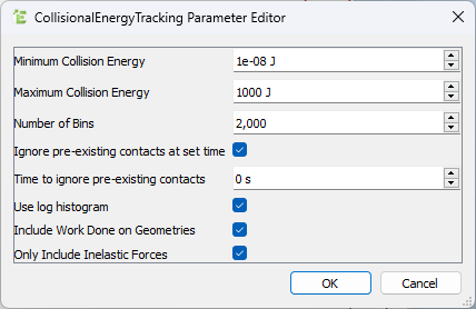

  7. In the CollisionalEnergyTracking Parameter Editor dialog box, specify values for the following:
    For Specify
    Minimum Collision Energy Indicates the lower bound of the energy loss histogram. This is a lower bound on the values that will be stored in the three counter custom properties.
    Maximum Collision Energy Indicates the upper bound of the energy loss histogram. This is an upper bound on the values that will be stored in the three counter custom properties.
    Number of Bins Indicates the number of bins to use in the energy loss histogram. This corresponds to the number of bins in each of the three counter custom properties. A larger value gives a better resolution but also potentially increases the noise of the data, meaning further post-processing may be required.
    Ignore pre-existing contacts at set time Indicates that contacts existing at the corresponding time will not be included in any calculations of the model, if enabled. This is useful if an exported deck with pre-existing contacts has this model added to it. Having this option enabled prevents the inclusion of data coming from collisions where only part of the collisional energy loss is summed.
    Time to ignore pre-existing contacts Indicates the time at which contacts will not be included if the previous setting is enabled. This should typically be the simulation start time.
    Use log histogram Sets the spacing of the bins to be distributed logarithmically, as opposed to linearly. Enabling this option is highly recommended. However, if you want to analyze negative energy loss values, a linear histogram with a negative minimum collision energy can be used instead. The energy loss values cannot be negative while this option is enabled.
    Include Work Done on Geometries If enabled, Particle-Geometry contacts are treated as identical to Particle-Particle contacts. If disabled, work done on the Geometries is ignored (the calculation is done as if the Geometries always have zero velocity.) With this option enabled, a steady-state system driven by Geometry motions and fixed particle count will show a net loss due to collisions, due to energy input from the Geometry kinematics being dissipated in the collisions in the system. With this option disabled, the Particle-Geometry collisions will exhibit large negative losses and the collisional energy loss as a whole will sum to zero in the steady state (it may be necessary to disable Only Include Inelastic Forces to achieve this.
    Only Include Inelastic Forces If enabled, only inelastic forces are used in the calculations. For more information about how they are used in calculations, see Potential Issues with Energy Loss Calculation.
    Note: The default values and selections are considered an appropriate starting point for most simulations.

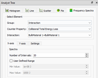

After running a simulation using the Collisional Energy Tracking model, use EDEM Analyst and select the Frequency Spectra tab to visualize the calculated energy losses. Here, you can plot the frequency or counts of the energy bins associated with each of the following three counter custom properties:
  • Collisional Normal Energy Loss
  • Collisional Tangential Energy Loss
  • Collisional Total Energy Loss

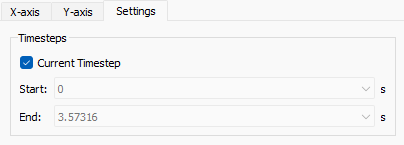

The spacing of the bin values on the X-axis will be either linear or logarithmic, depending on whether Use log histogram was previously selected when setting up the model. For the Y-axis, you can select linear or logarithmically spaced values.
By default, the data plotted will be for the current time step. This can be changed by clearing the Current Timestep checkbox in the Settings tab and selecting a desired range of values from the Start and End dropdown lists.

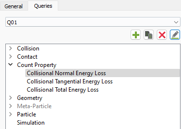

Additionally, you can export all the three counter custom properties as queries.
