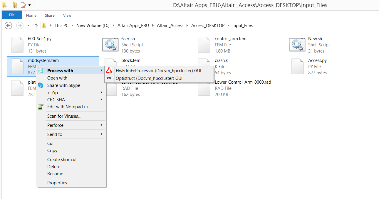

Submit a job by selecting a job input file from your project folder in Windows Explorer.
- Open your project folder in Windows Explorer.
- Right-click the job input file.
From the context menu, select Process with.
A list of solvers and saved job profiles along with the server name specific to the file type of the job input file are displayed.
Figure 1. Solvers and Job Profiles Specific to the Job Input File Type
- Select a solver or job profile.
