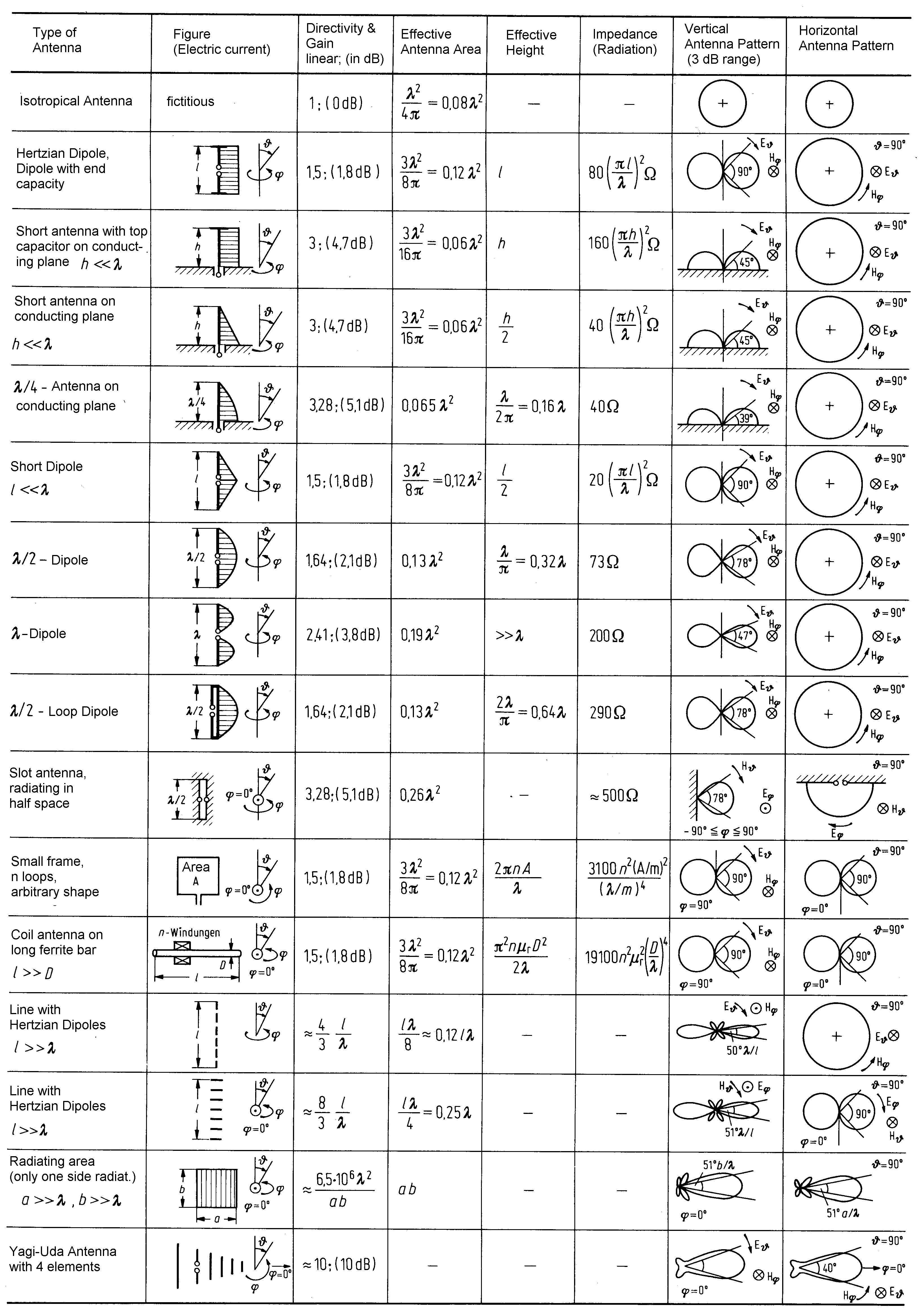

The radiation pattern of an antenna is a graphical representation or mathematical function that indicates the angular dependence of radiation from the antenna.
An isotropic radiator is an ideal (theoretical) antenna operating without losses and having equal radiation in all directions.
Commercial antennas do not radiate the same power density in all directions (in contrast to the isotropic radiator). There are always directions with higher power density and others with smaller power density.
Antenna patterns are described by parameters such as gain, directivity, pattern lobes, half-widths, equivalent radiation angle, and effective area.
Directivity is the ratio of the radiation intensity in a given direction from the antenna in relation to the radiation intensity averaged over all directions.
A radiation pattern lobe is a section of the radiation pattern surrounded by regions of relatively weak radiation intensity.
A half power beamwidth is the angular separation between the half-power (-3dB) points on the opposite side of the pattern maximum (major lobe).
