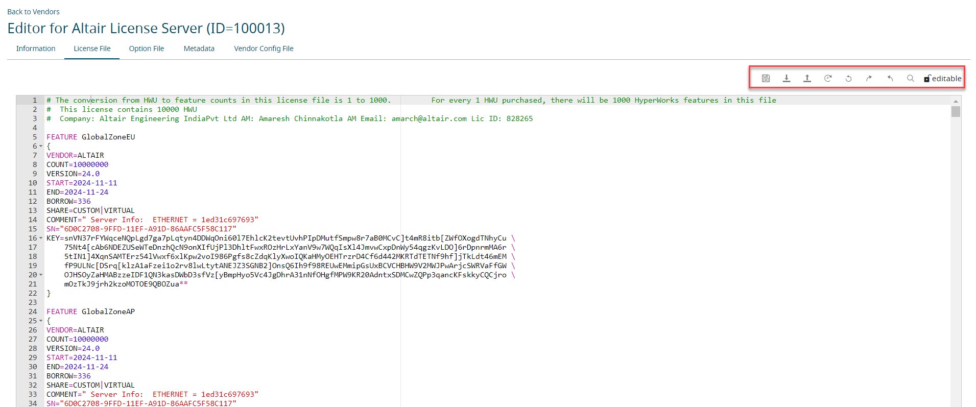

- Information - License server details are displayed.
- License File - License file information is displayed.
The
indicates that this is an editable
file.You can perform the following actions in the license file:- Save the license file after editing
- Download the license file
- Upload a new license file
- Revert the previous license file
- Reload the license file from the agent
- Undo and Redo
- Search for parameter in the license file

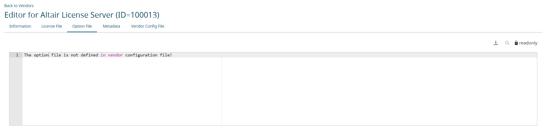

- Option File - View if there are any option file attached to the
license vendor.
The
indicates that this is a read only
file.You can perform the following actions in the license file:- Download the file
- Search for parameters

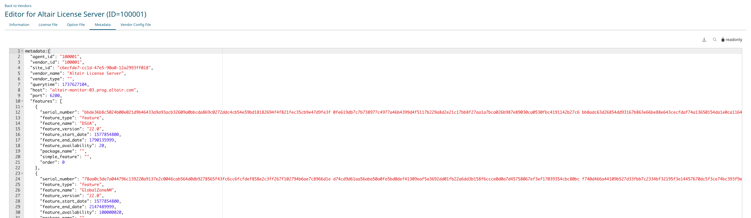

- Metadata - License server metadata information is displayed.
The

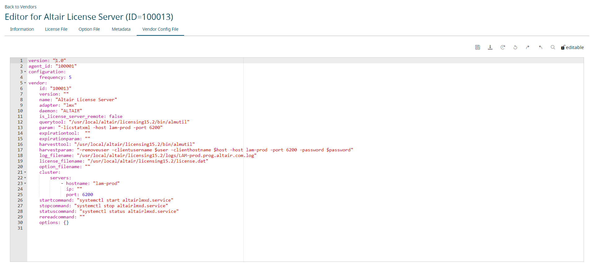

- Vendor Config File - The license vendor configuration file is
displayed.
The
- Revert the previous license configuration file
- Reload the license configuration file from the agent
- Undo and Redo
- Search for parameter in the configuration file
