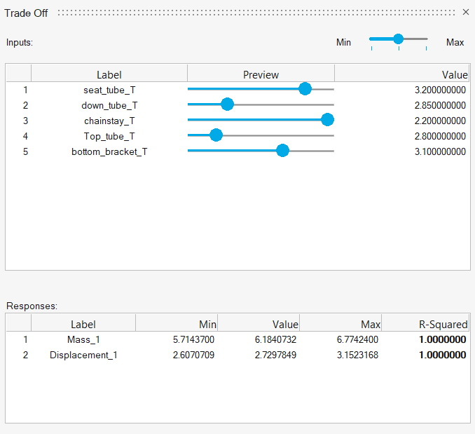

 - In the Inputs area, move the sliders to the desired values, or type values into the Value column.
                Review the predicted response values in the Responses area.
                Note:
- The Min and Max values in the Responses area indicate the minimum and maximum sampled values for the given responses based on the DOE results.
 - The R-Squared value is a statistical representation of the quality of a given response fit based on cross validation. R-Squared values will be color-coded to indicate the level of confidence that should be attributed to a given fit. The trade-off tool is very useful for showing trends. It is recommended that a verification run be performed to validate a predicted response.

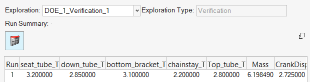

                Click the Verify button, Export,
                    and Run a verification.
                A verification is an exploration where a single solver job is run with the input design variable values set as they were in the trade-off panel.
Results for the verification exploration run can be used to verify the predictions. The results can be viewed in the Results Explorer by setting the verification exploration as the exploration.Figure 3.
