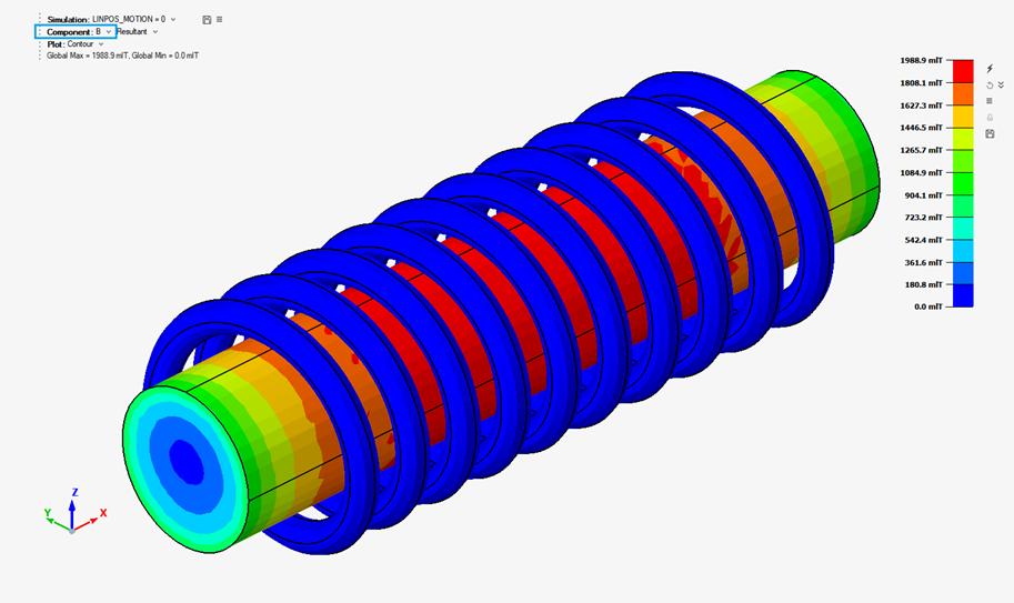

Isovalues of B

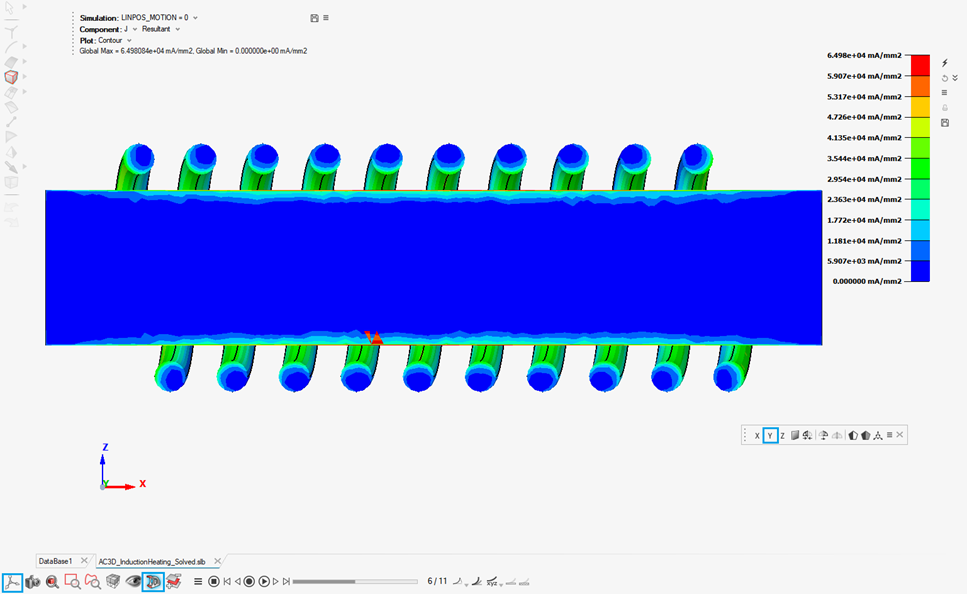

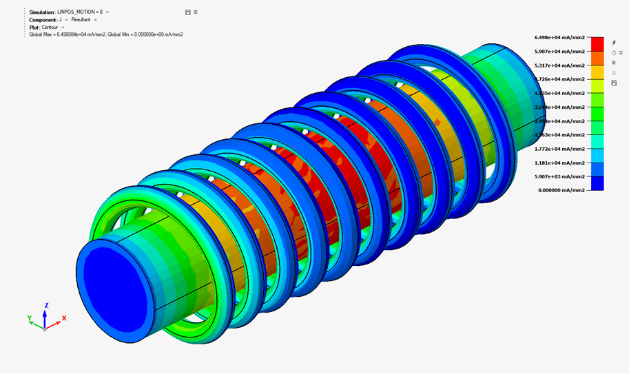

Isovalues of J

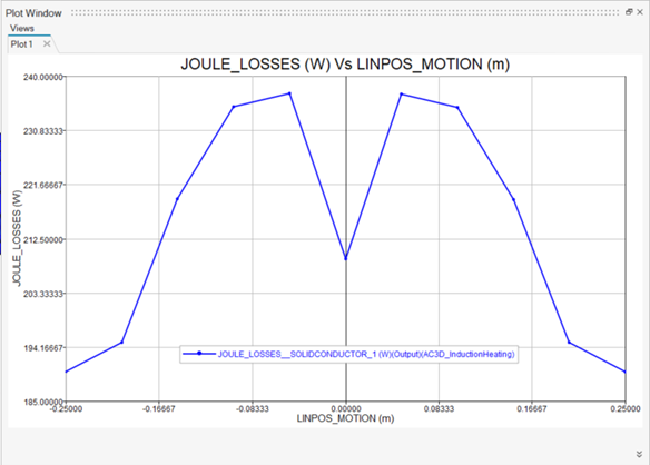

Joule Losses VS Linear position
