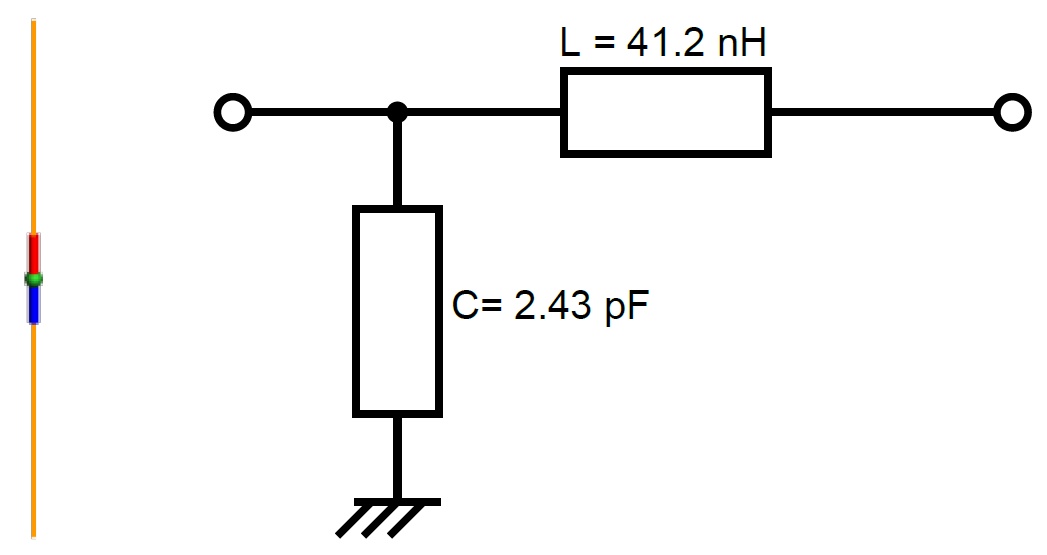

Using a Non-radiating Network to Match a Dipole Antenna
Match a short dipole for resonance at 1.4 GHz with an LC matching section. The matched network is modelled using a Spice circuit and S-parameters.
Note: The matching SPICE file (Match_circuit.cir) and
Touchstone file (Matching.s2p) are included with the
example.
