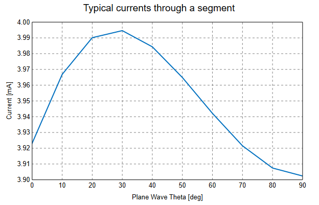

Create a Cartesian graph and add the segment currents to the graph.
Figure 1. The current in an arbitrary segment vs plane wave source incidence
angle.
![](../../../../images/feko/example_guide/EG_D03_magnetic_field_probe/graph_currents.png)
Note: Each segment will result in a slightly different current as a function of
the plane wave source angle of incidence.
