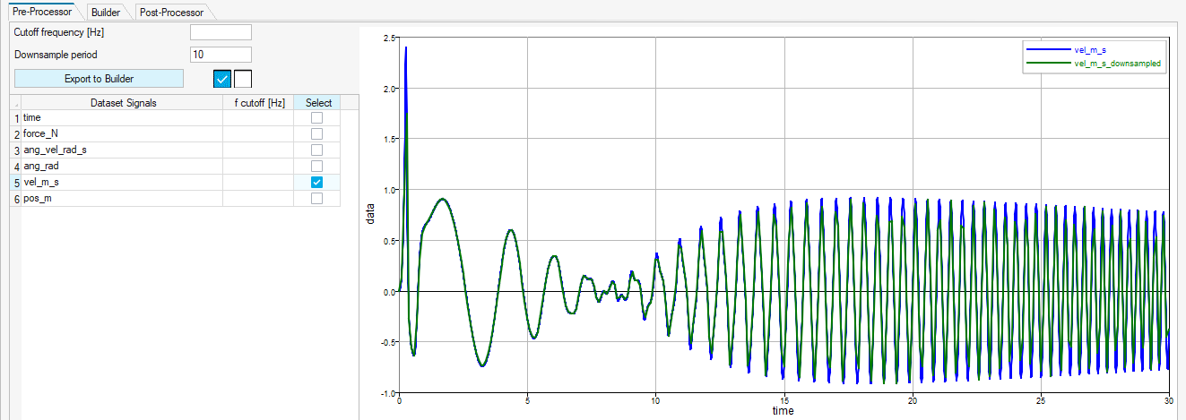

To set the downsampling ratio, enter a value in the Downsample period field, and then press Enter.
Figure 7. Downsample Data in Pre-Processor Tab
Note: The downsample period is applied to the entire dataset, not just the selected signal.

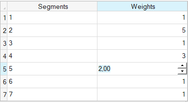

Weights for Segments
Add a weight to a segment.
To give more consideration to one segment than others, you can add a weight different from one to any segment. As a result, this segment is used multiple times for training with different seeds.
Figure 12. Weights Column
