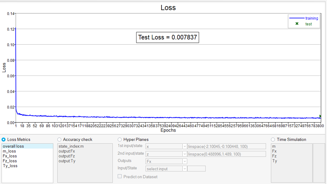

View the overall training, validation, and test loss.
Note: Check Loss is only available if Method has been set to Deep learning as the training method in the Builder tab.
Select the Loss Metrics radio button.
Figure 2. Loss Metrics Option
This loss is a constant value that represents the error made by the trained romAI model when predicting over the testing dataset. The data is reported in the text box of the loss chart and refers to the value calculated after the training as shown below:
Figure 3. Test Loss Value in Loss Chart

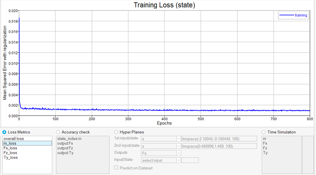

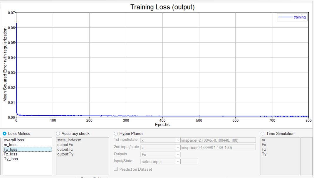

The data also shows the training/validation loss of each single output or higher-order state variable, such as velocity in this case.
Figure 4. Training Loss of State Variable
Figure 5. Training Loss of Output Variable
At this point, the typical machine learning considerations are valid, such as:
  • The lower the training error, the more accurate the ROM.
  • If the training and test loss is close to each other, then the training has converged.
  • If the training and test losses diverge, then the ROM might be affected by overfitting. In this case, you may want to consider increasing the regularization term.

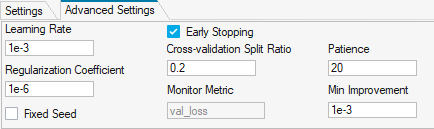

  • The cross-validation ratio is used to monitor the Early Stop criteria. To change the cross-validation ratio, select the Early Stopping check box as shown below.
Figure 6. Early Stopping Option in Advanced Setting

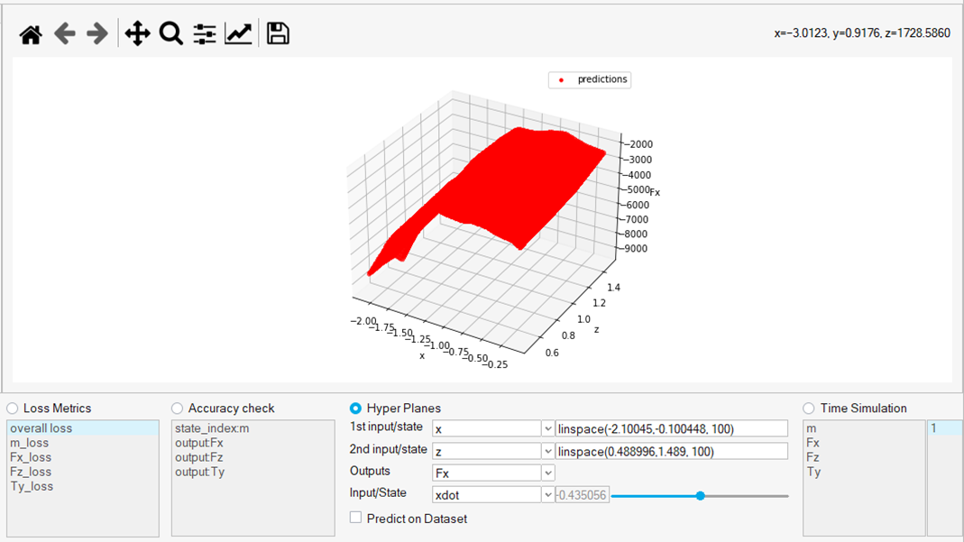

romAI draws two types of 3D plots:
  • Hyper planes: The application evaluates the trained romAI model over a range of user-defined input values and displays the output as a hyper plane. One output at a time can be displayed.
  • Scatter plots of Predictions vs Targets: The application evaluates the trained romAI model into a set of points contained in a dataset file and compares the output results with the target points contained in the same dataset file through a scatter plot. Only one output at a time can be requested.

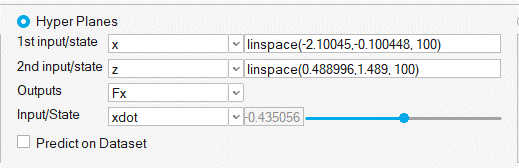

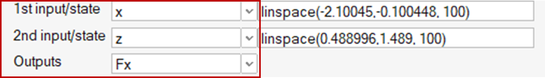

  1. Select the 1st and 2nd inputs from the Inputs/States menu for the x-axis, y-axis, and one output from the Outputs menu for the z-axis.
    Figure 10. Inputs and Outputs Fields

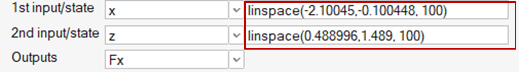

  2. Specify the range of the x- and y-axes using Compose OML syntax.
    Figure 11. Range of X- and Y-Axes
    The x/y grid is automatically created for the hyper plane. All other inputs and states are held constant.
  3. For each additional input and state that you want to include, you can specify the constant value for each through the menu and the slider.
    Figure 12. Additional Input/State with Value Slider
    After you have specified the values for all the inputs and states, the hyper planes are updated automatically.
    Figure 13. Updated Hyper Planes
    The axes are labeled with respect to the names of the selected inputs and states and output.

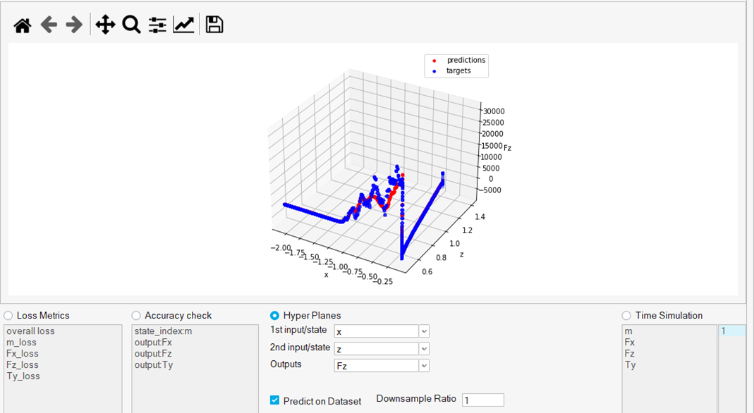

Generate Scatter Plots of Predictions vs Target
These plots require data from a dataset file.
  1. To create Scatter Plots of Predictions vs Targets, select a test dataset file.
    Note: The format and labels used in the file are the same as the ones used for training. Otherwise, an error dialog box shows up.
  2. Select the Predict on Dataset check box.
    Note: The edit boxes, menu, and slider on the Hyper Planes panel are invisible in case of the Predict on Dataset option.
  3. Select the desired inputs and state variables from the Inputs/States box to create the x- and y-axes.
  4. Select the Outputs that you want to evaluate and compare.
  5. Enter the Downsample Ratio.
    The downsample value determines the number of points in the dataset file that will be used for the evaluation/comparison. For example:
    • A downsample ratio of 1 means that the comparison between the romAI output and the target (contained in the dataset) will be performed for all the points in the dataset file.
    • A downsample factor of 0.1 means that the comparison between the romAI output and the target (contained in the dataset) will be performed for a tenth of the points in the dataset file.
    • When a dataset file is very large, adjusting the downsample ratio can greatly improve the plot performance. By default a downsample ratio value less than 1 is used on initial plots when the dataset is large.
    Figure 14. Downsample Ratio of 1

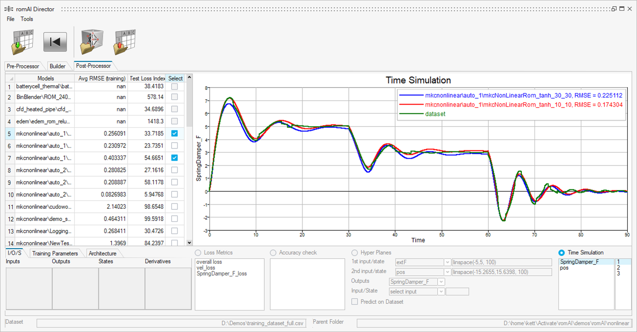

If romAI is used to generate dynamic ROMs, it is important to have a tool that easily performs preliminary time simulations to assess the accuracy of the transient behavior after the romAI model has been trained.
The Time Simulation tab has been designed to perform these time simulations in just one step.
Use the Import icon to select a dataset file, if not already selected. The selected dataset file name can be seen in the file name info section at the bottom of the dialog box.
Note: The format and labels in the dataset file are the same as those in the training file.
A time simulation is triggered. After the simulation runs successfully, the plot is updated.
Figure 15. Time Simulation Plot
The following are drawn in the plot:
  • Blue line: The dynamical results produced by the romAI model, given the inputs and the initial state conditions that are contained in the dataset file.
  • Green line: The target time history.
  • RMSE Metric: Root Mean Square Error calculated between the two signals is shown in the legend.
    Note: The RMSE is calculated for the segment and output currently active.
Use the list box to select the output of the romAI model that you want to plot.
If the loaded dataset file contains multiple time histories, you can select the desired history in the segments list box beside the output list box.
Compare Time Simulations of Several Models
The table of models lets you select several models to compare simulation results based on the same data inputs.
Models that do not fit the first selected model cannot be selected; their check box is gray. To switch to another model, deselect all models and select the new one.

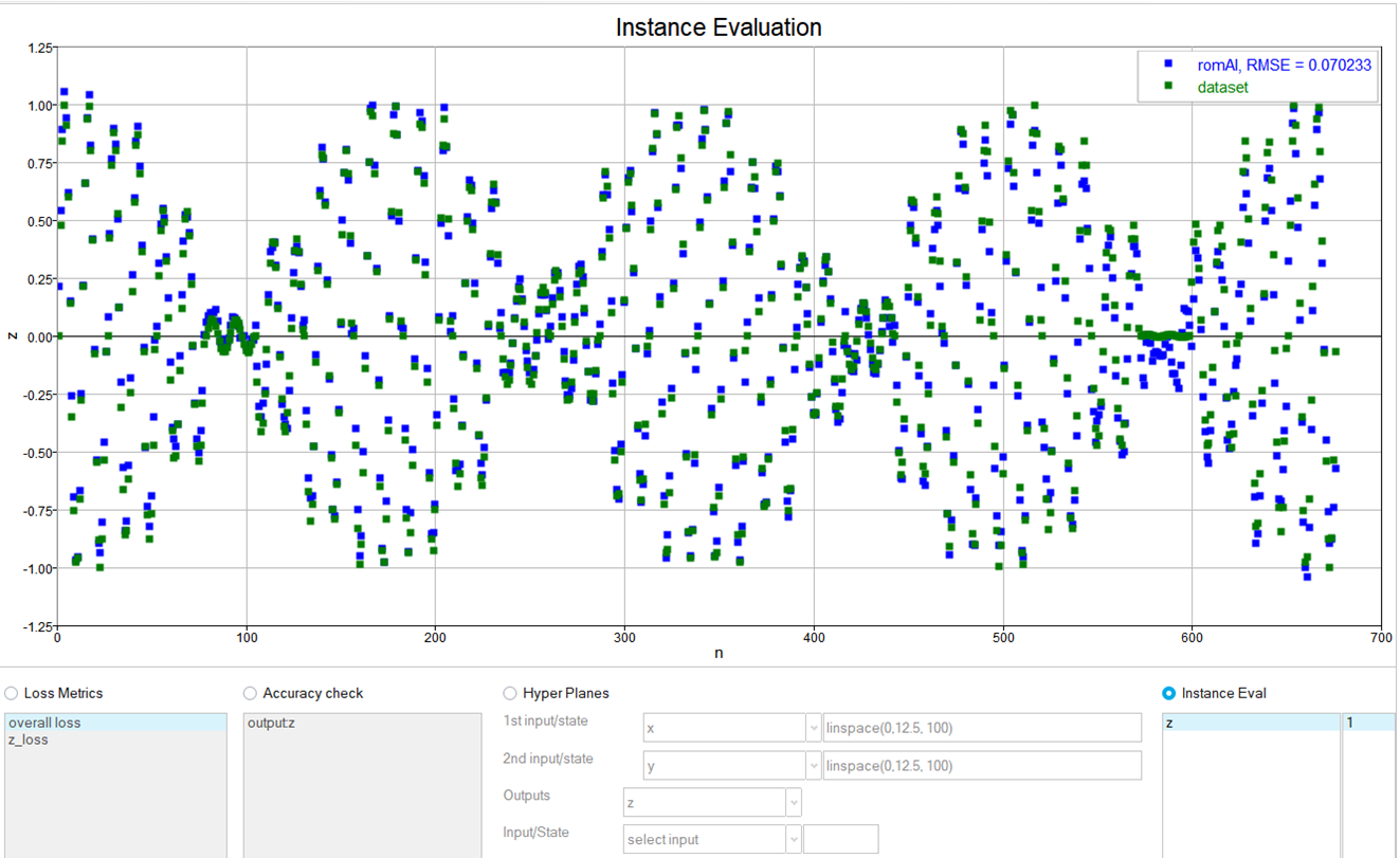

Repeating the same steps as before, the following scatter plot is generated for a static ROM:
Figure 17. Instance Evaluation Plot
  • Blue dots: The static results produced by the static romAI model, given the inputs contained in the dataset file.
  • Green dots: the target results.
  • RMSE Metric: Root Mean Square Error calculated between the romAI and dataset instances.
    Note: RMSE is calculated for the segment and output currently active.

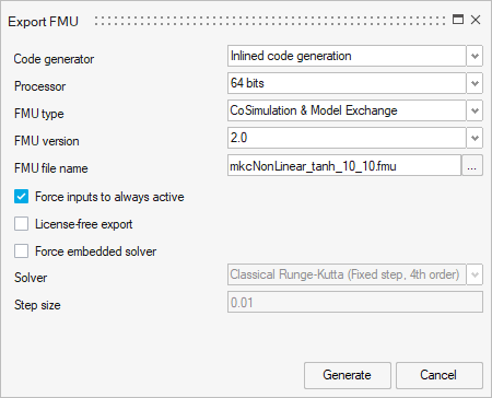

FMU Export
The FMU export tool can be accessed from Tools menu.
This option lets you generate an FMU of the romAI without creating a separate block model with a romAI block.
Figure 19. Export FMU Dialog Box
The parameters and options of the Export FMU dialog box are the same as in the Code Generation dialog with FMU selected as the target.
Two code generation technologies are available for selection: Standard code generation or Inlined code generation.
Both types of FMUs are supported: ME (Model Exchange) and CS (Co-Simulation).
