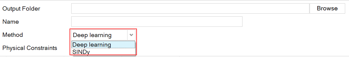

Specify the ROM Creation Method
Select a method for the creation of the ROM.
From the Method drop-down list, select Deep learning or SINDy.
Figure 3. Select the ROM Creation Method
Deep learning is the default method and is preferred for most use cases.
When Deep learning is selected, romAI leverages machine learning techniques in combination with classical system theory, whereas SINDy uses sparse regression packages for the system identification.
The Deep learning method can be used to identify both static (state-less) and dynamic systems, whereas SINDy works only with dynamic systems.
SINDy may be used in situations where the approximate equation of the system is required to be identified (white box). SINDy can also be leveraged as a first step before training a model with the romAI method, in order to identify any predominant functions that could be artificially added as inputs of the model.

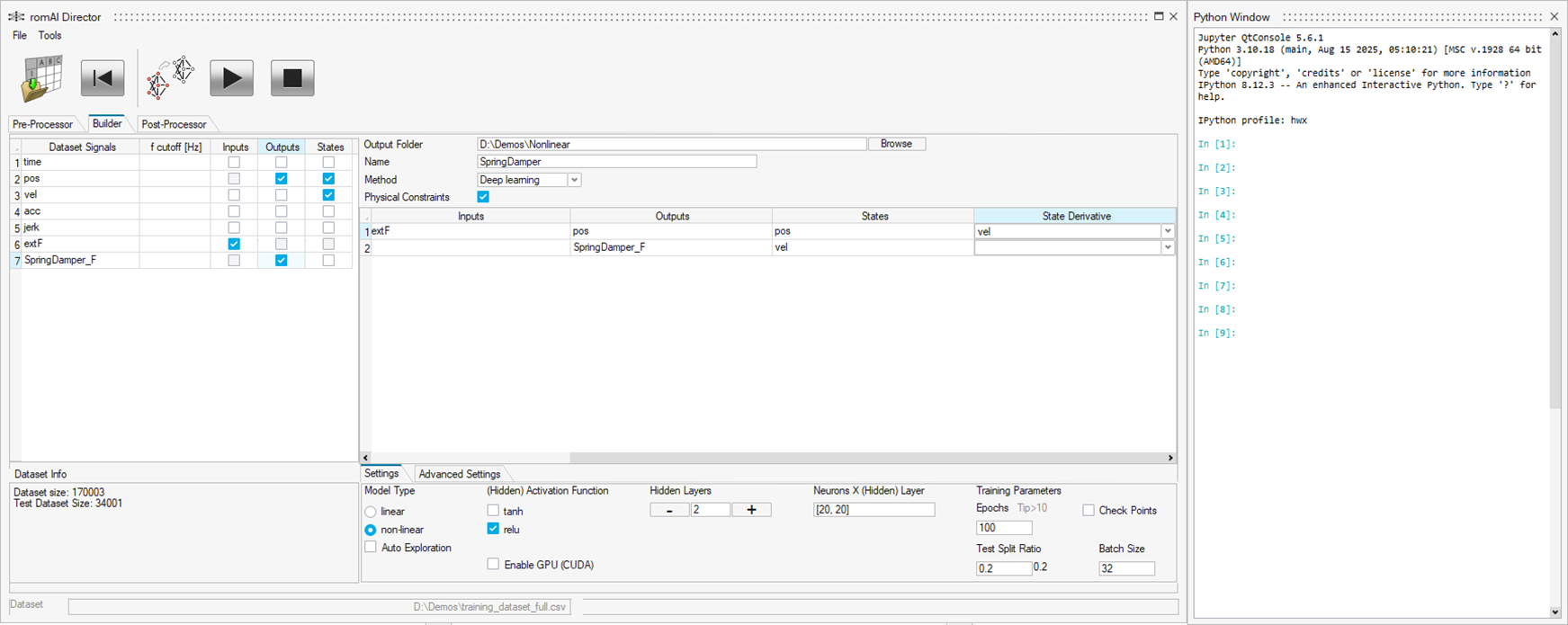

Define Inputs, Outputs, and States
After you have loaded the data, the Signal Table is automatically populated and you can specify your inputs, outputs, and state variables, as applicable.
Figure 4. Signal Table
Select the Input, Output, or State using the check box. The Features Table on the right side populate accordingly.
Figure 5. Features Table
To remove data labels from a desired box, deselect the check box.
You must specify at least one input and one output. State variables are optional. As is common in classical system theory, some, or all, state variables can be outputs as well.
Add and Edit Physical Constraints
Adding physical constraints is an option if state variables exist. If state variables do exist, it is possible for one state variable to be the derivative of another. Since romAI technology is a mix of AI and system modeling techniques, the romAI application can take this into account and produce a better ROM. Hence, it is good practice to specify the derivative variables.
If one or more state variables are specified, the Physical constraints check box is visible.
If you select the check box, a column is added to the Features Table. This column contains the names of the state variables in a drop-down list. Here, you can select the name that specifies which variable is the derivative, if applicable, for each state variable.
For example, given the following set of state variables:
Figure 6. Example Set of State Variables
Select the Physical Constraints check box, and the following table appears.
Figure 7. State Derivative Column
In the State Derivative column, use the drop-down cells to specify the derivatives.
Figure 8. Specify Values in the State Derivative Column
Note: If the Physical Constraints check box is deselected, the physical constraints will not be considered in the ROM.
To clear the derivative column, select an empty cell in a drop-down list. To clear all derivatives, deselect the Physical Constraints check box.

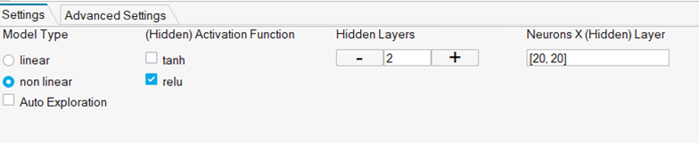

Define the Model Architecture
Deep Learning
The ROM is based on an MLP (multilayer perceptron) structure.
  1. Select a model type:
    • linear: The model architecture is defined by default, and no further action is required.
    • non linear: Continue to the next step.
    Figure 9. Model Type Options
  2. For the (Hidden) Activation Function, select tanh or relu.
  3. Enter the number of hidden layers of the MLP. Click the + and – buttons to increase or decrease the number of hidden layers. You can also type the exact number of layers directly in the text box.
  4. Enter the number of neurons per layer. Type the number in the text box. You can also leverage the OML syntax and type square brackets for matrices, and commas as column separators, as required.
    Figure 10. Non Linear Settings

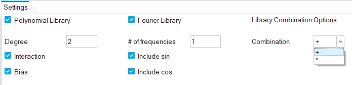

SINDy
Define the SINDy model architecture in the Settings tab.
SINDy uses sparse regression to identify a linear combination of basis functions that most effectively represents the dynamic behavior of the physical system. These basis functions are part of different feature libraries.
Figure 11. Settings Tab when SINDy Method is Selected
  • Polynomial Library:
    • Degree: Relates to the degree (power) of the polynomial features.
    • Interaction: If enabled, interaction features are produced (e.g., x1 * x3).
    • Bias: If enabled, a bias term is included in the feature.
  • Fourier Library:
    • # of frequencies: Relates to the number of frequencies to use on the sine or cosine functions (e.g., sin⁡(x), sin ⁡(2x), … sin⁡ (#frequenciesx)
    • Include sin/cos: If enabled, includes according terms in the feature library.
  • Library Combination Options:
    • In romAI Director, you have the option to use the Polynomial and Fourier feature libraries or a combination of those. You may concatenate (+) or tensor (*) multiple libraries together for more flexibility.

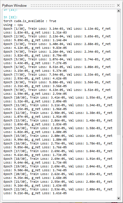

  3. Click the Train icon to launch the training procedure.
    After the training begins, you can view the progress in the Python window.
    Figure 14. Training Progress in Python Window

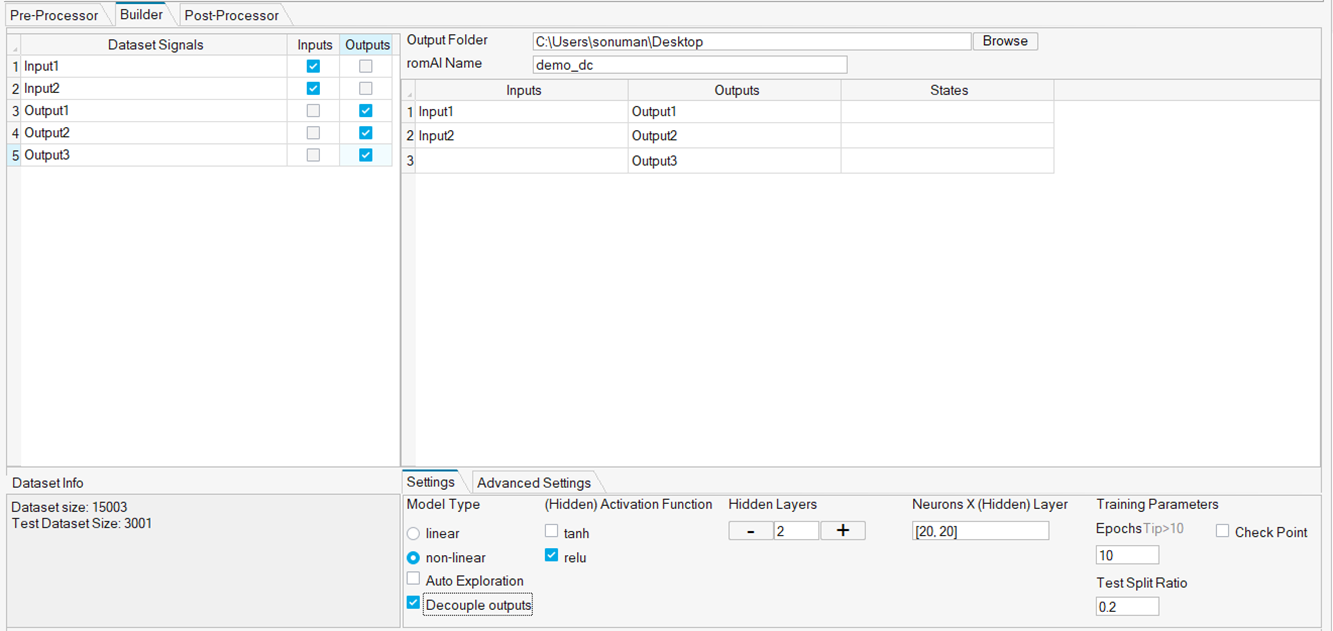

In the case of static models, it could be better to divide one single model with multiple outputs into several models with single output.
Training a model with single output result in better accuracy as compared to the model where there are multiple outputs. The Decouple outputs option lets you automatically create multiple model with single outputs.
Figure 15. Decouple Outputs Option Selected in Settings
As shown in image above, if the model is trained with Decouple outputs selected, then three models are generated and are stored in a folder named with following syntax: <romAI name>_<output_name>_decoupled<integer>.
The integer in the end is added to avoid overwriting of the model files. The folder name is also shown in the message box which is shown after training.
An Compose OML file is also created along with romAI models with single outputs.

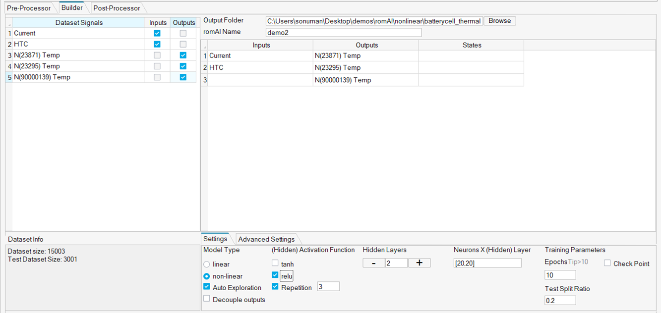

Auto Exploration allows you to run multiple models with different combinations of activation function, hidden layers, and number of neurons in one click.
Figure 16. Auto Exploration Setting
  1. Select the Auto Exploration check box.
  2. Select the Activation Function options.
  3. Enter the minimum and maximum number of hidden layers, and the increment step for the hidden layers.
  4. Enter the minimum and maximum number of neurons per layer, and the increment step for the neurons.
  5. Click the Start Training
    icon.
    All the models generated from Auto Exploration training are put in an auto_<integer> folder. This folder is created inside the output folder. It is done to make the post-processing easy.
