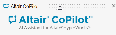

  3. To hide the chat interface, click Altair CoPilot . Click it again to return to your questions.
  4. Drag or double-click the window header to undock or reposition the window to another location within the application.
