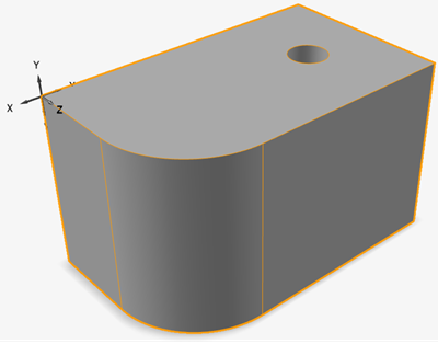

Figure 1. A part with a user-defined coordinate system.

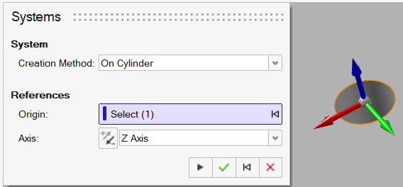

    On Cylinder Use the Origin collector to click the cylindrical face or circular edge of a cylinder and use the Axis dropdown to select the axis that aligns with the center of the cylinder.
    By default, the origin of the system is displayed at the center of the circle or the centroid of the cylinder.

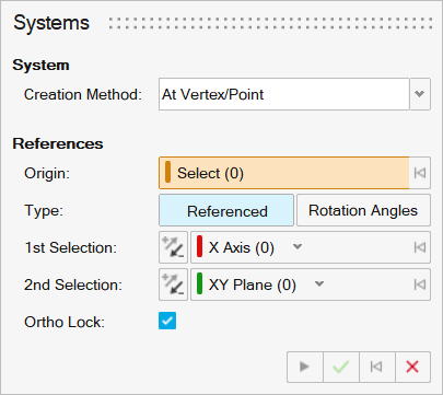

  5. Select the type of system you want to create.
    • Select Referenced to create references to geometric entities in the model, such as vertices/points, edges, and faces.
    • Select Rotation Angles to define a system based on the rotation angles.
  6. Select the references or rotation angles for the system. To translate or rotate the system:
    • If Referenced is selected, use the 1st Selection collector to select the X, Y, or Z axis as the first reference. You can use the down arrow to select which axis you want to use.
      If Referenced is selected, use the 2nd Selection collector to select the plane you want to use as the second reference. You can use the down arrow to select which plane you want to use.
    Tip: Select Ortho Lock to allow projections to find the intersection of the 1st Selection and 2nd Selection in case the second selection breaks. When Ortho Lock is not selected, Inspire will not allow users to create systems if the 2nd selection breaks orthogonality.
    • If Rotation Angles is selected, enter the θx, θy, θz Euler Angles to rotate the system.

  • You can create cylindrical coordinate systems using the On Cylinder creation method. Use the Origin collector to select the cylinder, and use the Axis dropdown to select which axis corresponds to the center of the cylinder.
