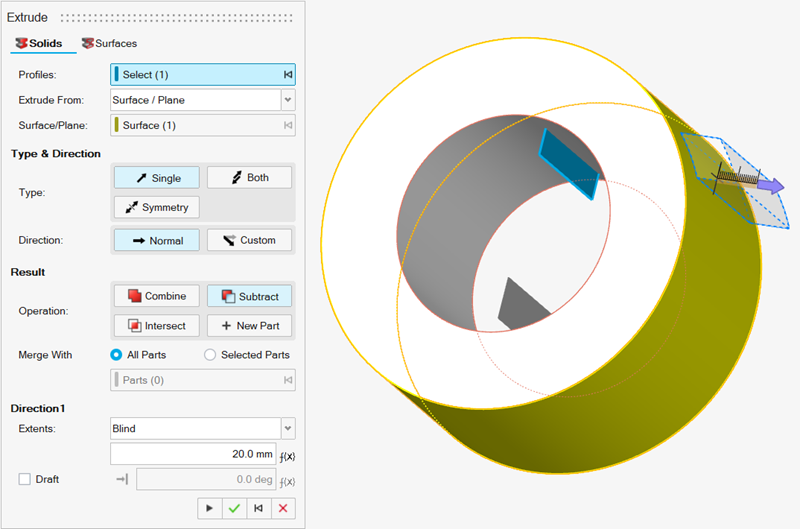

  2. Choose the entity type that you'd like to create:
    • Solids: Extrude as solids.
    • Surfaces: Extrude as 3D surfaces with optional end caps.
  3. By default, Select is automatically turned on. Do one of the following:
    • If you selected Solids in the last step, select one or more closed curves.
    • If you selected Surfaces in the last step, select one or more curves or 2D surfaces.
    Note: To deselect a curve or 2D surface, hold down Ctrl while clicking. To clear all selected features, in the microdialog click Clear Selection.
  4. Choose a Direction:
    • Single (default): Extrude in one direction.
    • Both: Extrude in both directions.
    • Symmetry: Extrude symmetrically in both directions.
  5. Choose a Reference orientation:
    • Normal (default): Make the extruded shape normal to the curve or 2D surface.
    • Custom: Extrude in a custom direction by selecting one of the following options.
      • Select: Select a linear edge or an axis to which you want to align the extruded shape.
      • Free: Freely orient the extruded shape by dragging the curved arrow or entering an angle in the microdialog.
  6. Choose a Result type:
    • Merge (only available for Solids): Merge the extruded shape with the existing parts.
    • Subtract (only available for Solids): Carve out the extruded shape from the existing parts.
    • Intersect (only available for Solids): Retain only the intersecting portions of the extruded shape and the existing parts.
    • New Part: Create a new part from the extruded shape.
  7. If you selected Solids, choose a Merge method:
    • All Parts (default): Merge the extruded shape with all parts that touch the extruded shape.
    • Parts: Select the radio button to merge the extruded shape with selected parts. Then select the parts that you’d like to merge the extruded shape with.
  8. If you selected Surfaces for the entity type, you can add or remove End caps:
    1. None (default): Do not include end caps.
    2. Both: Add end caps at both the start and end of the extruded shape to create a solid.
    3. Start: Add an end cap at the start of the extruded shape.
    4. End: Add an end cap at the end of the extruded shape.
