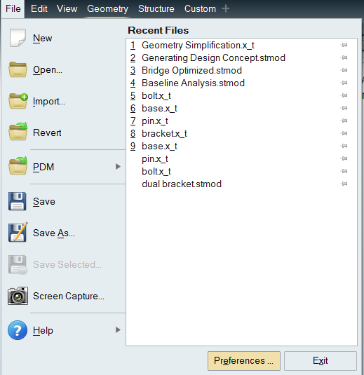

Select the File menu and click the
Preferences button to open the Preferences.
- Under Category, select Inspire: Run Options and enable Run in model directory, then click OK.

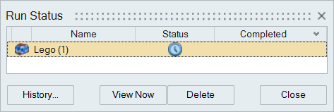

Set up and run an analysis.
The status icon in the Run Status window indicates that Inspire Cast is waiting for the run file to be manually copied to the remote server.

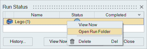

Right-click on the run name and select Open Run
Folder.
- Copy the run file and manually submit it to your remote job server queue.
