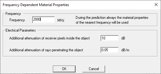

Similar to material properties of buildings, different properties can be assigned to the vegetation blocks. The handling is identical to the handling of normal building object properties. The only difference is that a different dialog comes up:
Figure 2. The Frequency Dependent Material Properties dialog.
