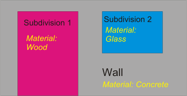

Figure 1. Insertion of subdivisions.
Generally, a subdivision behaves very much like any other wall, except for the fact that it
is assigned to a specific wall and is not allowed to be located outside this wall. The
subdivision may be moved or resized inside its wall just like any other wall and its
properties can be changed independently from the properties of the assigned wall.Figure 2. Wall with subdivisions.
Each wall can have an arbitrary number of subdivisions. The only constraints are:
subdivisions must be totally inside their walls and parallel to the plane of the
wall
subdivisions cannot intersect each other
Apart from holes, each subdivision can have different and individual material properties.
This gives a maximum flexibility to model the local environment as accurate as possible.
