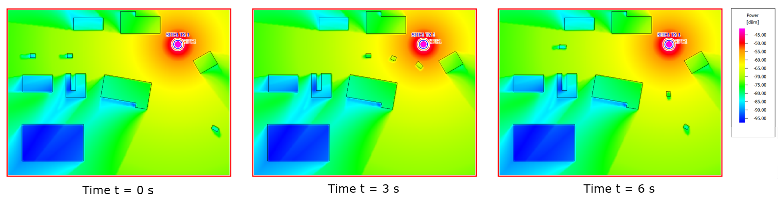

The results are computed for six time stamps in this model, from 0 s to 6 s in steps
of 1 s. The received signal power is displayed for three different timestamps, see
Figure 2.Figure 2. Received signal power for three different timestamps.
