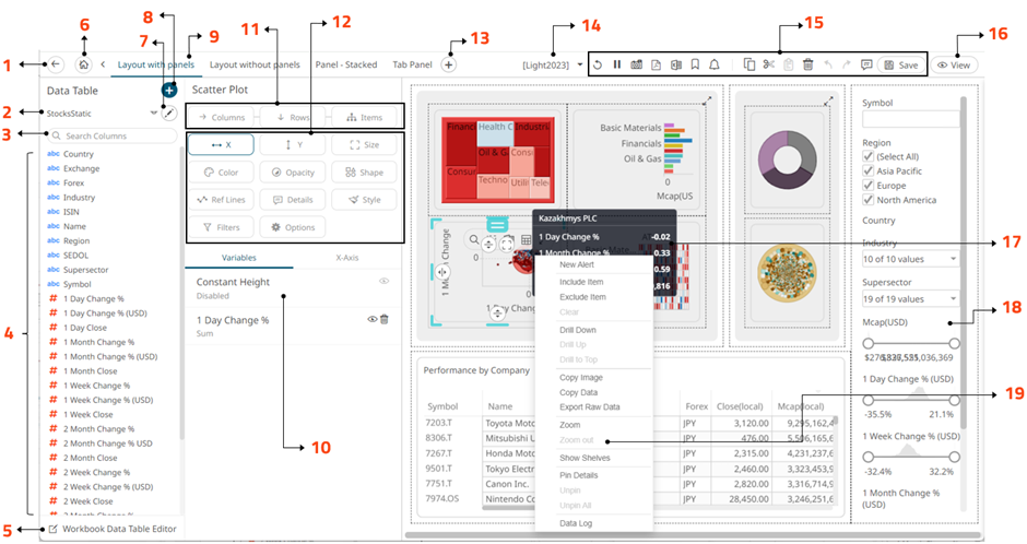

Using the Open Workbook in Design Mode
The Open Workbook in Design Mode view is composed of the following sections.
| Section | Description |
| 1 |
           Back Exit the Workbook in Design Mode to go back to the Workbooks page.  |
| 2 |
           Data Table Selected data table.  |
| 3 |
           Search Columns Allows you to search for columns in the selected data table.  |
| 4 |
           Data Table Columns Columns to drag to dashboard visualizations and parts.  |
| 5 |
           Workbook Data Table Editor Displays Data Table Editor layout where you can further configure the data table.  |
| 6 |
           Home Allows you to go back to the Welcome page.  |
| 7 |
           Edit Data Table Opens the Edit Data Table Wizard. Enabled when the data table was added using the  |
| 8 |
           Add Data Table Opens the Add Data Table Wizard.  |
| 9 |
           Dashboard Selected dashboard where you can add, edit, and delete visualizations, filters, actions, You can also create, edit, duplicate, rearrange, and delete dashboards.  |
| 10 |
           Columns Columns dragged to the X variable of the visualization.  |
| 11 |
           Breakdown, Columns, and Rows Allows you to define hierarchical structures for the visualization  |
| 12 |
           Visualization Variables and Filters Variables and filters that can be defined for the visualization  |
| 13 |
           New Dashboard Allows you to add a new dashboard. You can also opt to select a template to use.  |
| 14 |
           Workbook Theme Select the workbook theme.  |
| 15 |
           Toolbar Toolbar options in the Workbook in Design Mode  |
| 16 |
           View Go to Workbook in View Mode  |
| 17 |
           Show Details Displays information available in the Details variable of a visualization  |
| 18 |
           Filters Filters added on the dashboard  |
| 19 |
           Visualization Context Menu See Context Menu for more information.  |
