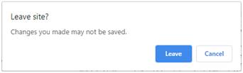

Also, before the list of available dashboards in the workbook is the Back
icon.
Click this icon to go back to the Workbooks and Folders Summary page.
If the workbook is not yet saved, a notification displays.
You can either click:
to leave the page without saving and go back to the Workbooks and Folders Summary page.
, then click
to save the changes done on the workbook. Then click
and pauses the streaming data sources.
to save before leaving the page.
