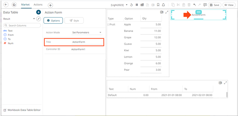

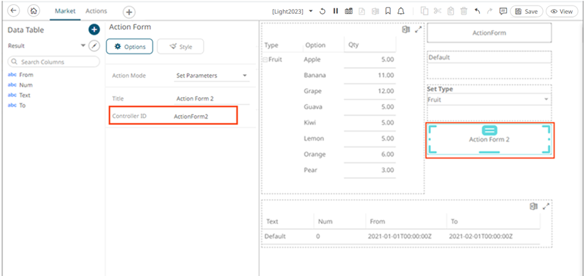

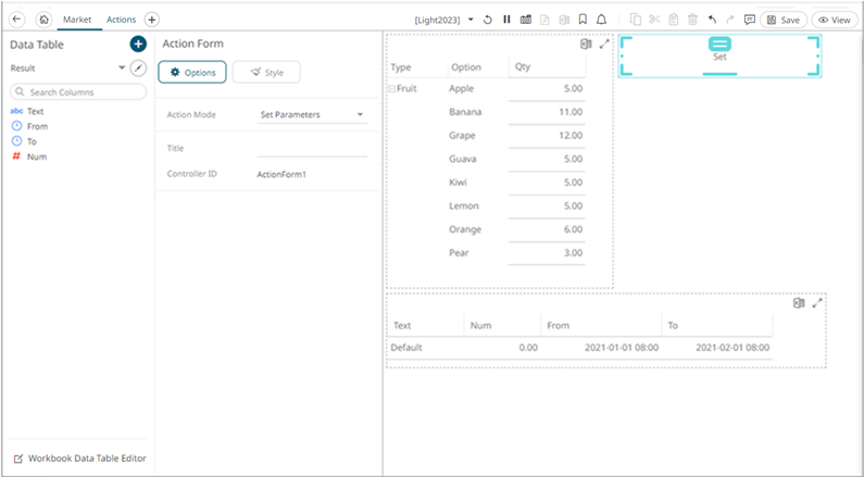

  1. After double-clicking or drawing a rectangle on the dashboard canvas, scroll to the bottom of the Part Types pane and select Form    icon.
    The Action Form pane is displayed, and the Action Form part is added on the dashboard canvas. The Controller ID is automatically generated (e.g., ActionForm1) which is used when associating the form to other action parts.
  2. Optionally enter the action form Title. The title of the form on the dashboard is updated.

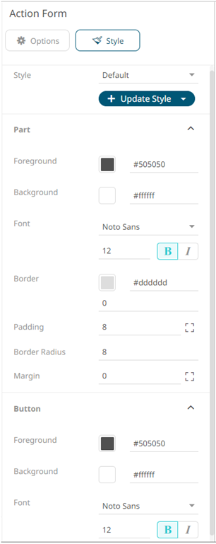

  4. To set the style of the Action Form, click Style  .
    The page updates to display the Style pane.
    See Defining the Style of General Parts for more information.
  5. Click Update Style   and select any of the following options:
    • Set current as default – Save the changes and set it as the default.
    • Create custom style – Save the changes and set it as a custom style.

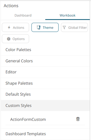

      The Style pane updates to display the Title control.
      • Enter the custom style's Title.
      • If there are additional changes made, click Update Current Style in the Update Style drop-down.
      The new custom style is added to the Workbook > Theme > Custom Styles list.
      If published, the custom style configuration of the Action Form will be added to the Global custom styles list and can be applied to other parts.
    • Reset to default – Revert to the original default settings.

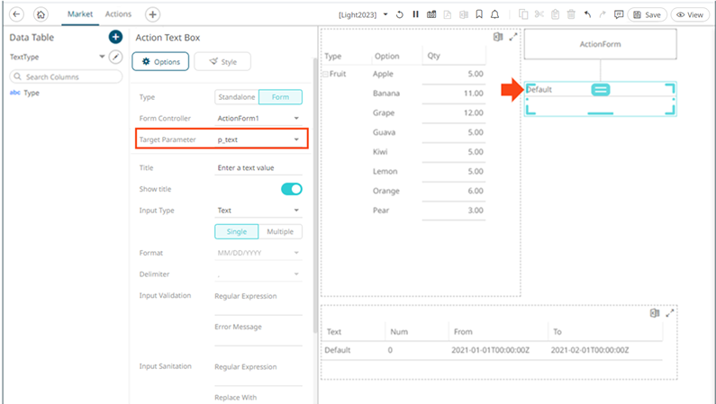

    Sample 1: Using the Set Parameter mode and adding Action Text Box and Action Dropdown components to ActionForm1 with the following target parameters.
    Action Part Target Parameter Default Value
    Action Text Box
    p_text
    Default
    Action Dropdown
    Type
    Fruit
    The action parts can be configured to either be a Standalone or a Form component.
    When an action part is set to Form, it can be connected to any form controller on the same dashboard. The parameters that the action part can set depends on how the form is configured.
    If a part should not be connected to a form, it can be set to Standalone instead.

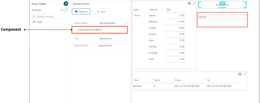

    A line connects the component to the associated action form.
    Upon selection of the action form, it lists p_text(ActionTextBox1). This means that the parameter p_text is being set by the connected action part ActionTextBox1.

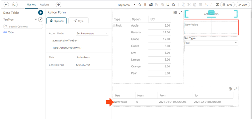

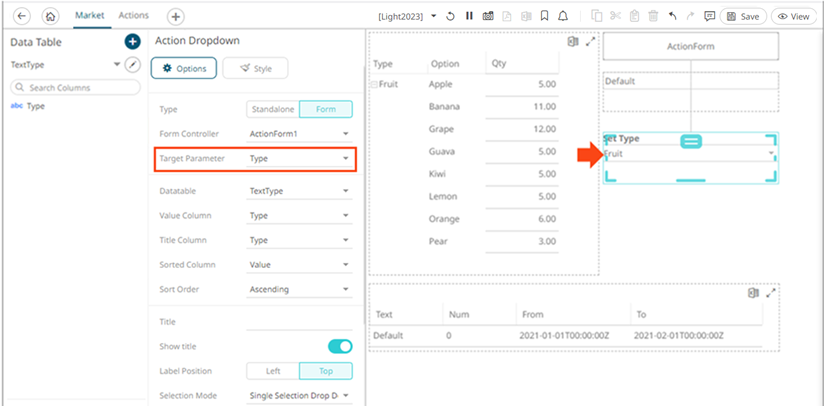

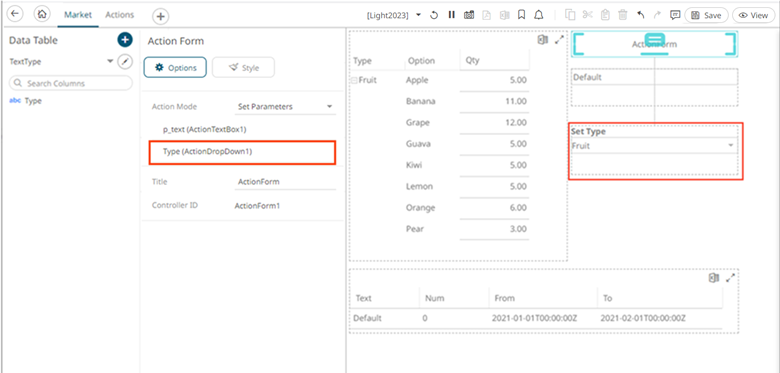

    For the second component, again a line connects it to ActionForm1.
    Upon selection of the action form, it additionally lists that the Type parameter is being set by the newly connected ActionDropDown1 part.
    Changing the value in the action text box from Default to New Value and clicking the form button will trigger the Set Parameter action and set the value of p_text on the dashboard.

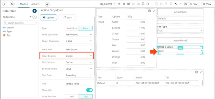

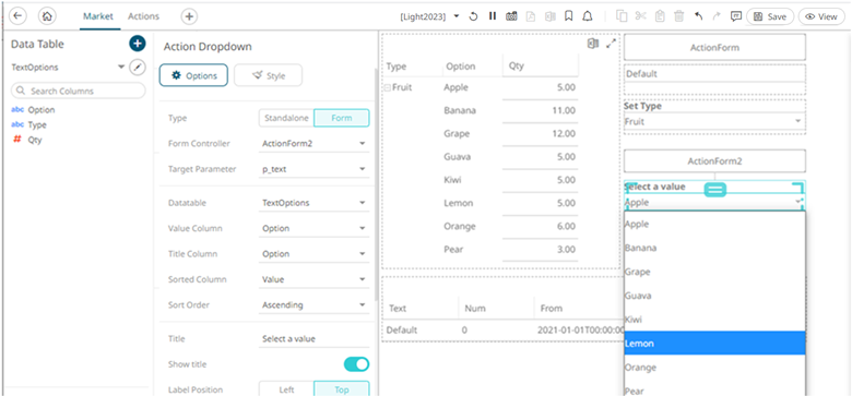

    Sample 2. Using the Set Parameter mode and adding a new Action Form (ActionForm2) with an Action Drop Down component:
    Action Part Value Column Target Parameter Default Value
    Action Dropdown
    Option
    p_text
    Default
    The Controller ID is automatically generated (e.g., ActionForm2) for the new action form.

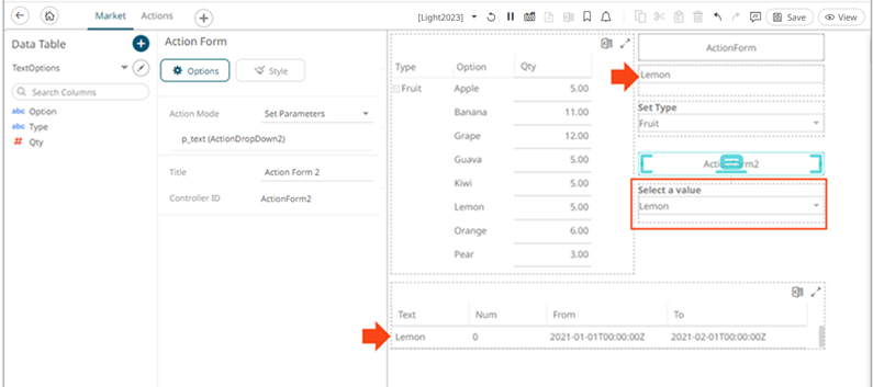

    For the action dropdown component, the target parameter is p_text and the value column is Option.
     This means that the value selected in the dropdown list will update the p_text parameter on the dashboard after clicking ActionForm2.
    For example, when selecting Lemon in the dropdown, it sets the p_text parameter for all action parts connected to the form without updating the parameter on the dashboard. The parameter will only be set on the dashboard after clicking the form button.
