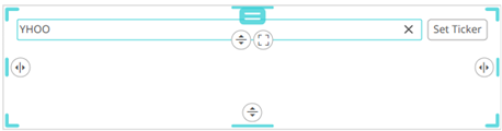

  1. After double-clicking or drawing a rectangle on the dashboard canvas, scroll to the bottom of the Part Types pane and select Action Text Box  .
    The Action Text Box pane is displayed, and the Action Text Box part is added on the dashboard canvas.

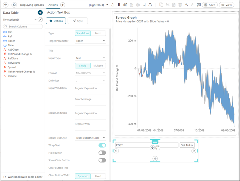

    For this example, the following parameters are defined:
    Parameter Name Type Default Value
    Ticker
    Text
    COST
    Slider Value
    Text
    0
    These parameters are used on the Title of the Line graph (e.g., Price History for {Ticker} with Slider Value = {Slider Value:0.00%}).

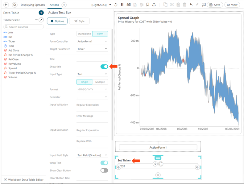

  2. The action text box can be configured to be either a Standalone or a Form component.
    When set to Form, the action text box can be connected to any form controller on the same dashboard. The parameters that the action part can set depends on how the form is configured.
    NOTE: An action form part must be defined first to associate the action text box as a component. Refer to Adding an Action Form more information.
    A line connects the component to the associated form. By default, the Show Title slider is turned on and the title is displayed to describe what parameter the text box is setting (e.g., Set Ticker). Tap to slider to turn it off.
    If the action text box should not be connected to a form, it can be set to Standalone instead. Select the Target Parameter that will be updated by this action part.

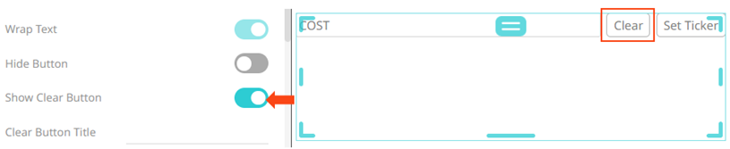

  11. Tap the Show Clear Button slider to display a button that will clear the text box when clicked.
  12. Enter the Clear Button Title, if required.
