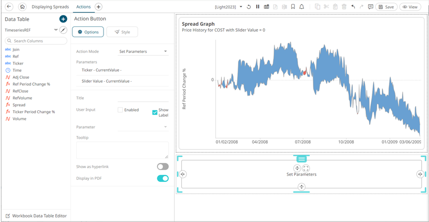

    For this example, the following parameters are defined:
    Parameter Name Type Default Value
    Ticker
    Text
    COST
    Slider Value
    Text
    0
    These parameters are used on the Title of the Line graph (e.g., Price History for {Ticker} with Slider Value = {Slider Value:0.00%}).

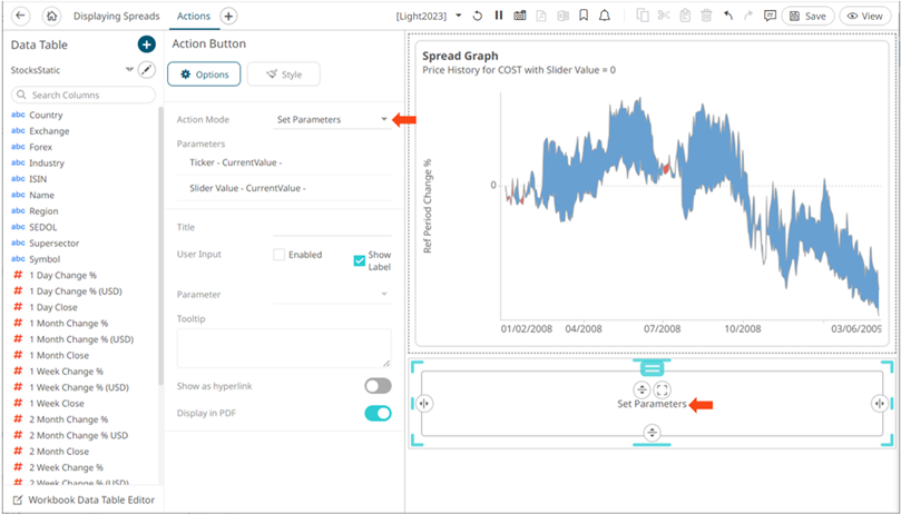

  2. Select any of the Action Modes:

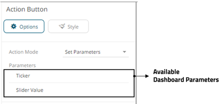

    • Set Parameters
      The Parameters pane lists the available parameters to set the data loading for each interaction with the Action Button.
      Click on a parameter instance to expand and set the values that the action requires.

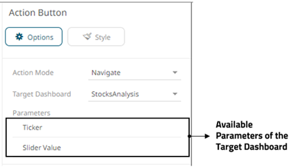

    • Navigate
      Allows the selection of the dashboard where you want to pass the parameters.

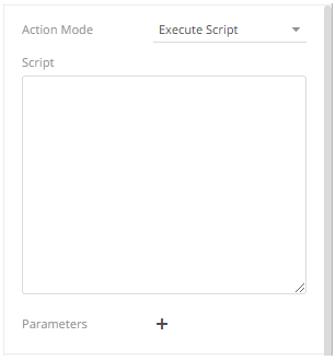

    • Execute Script
      Allows the execution of a script.
      Enter the parameterized Script.
      The parameters are written within curly brackets, {ParameterName}.
