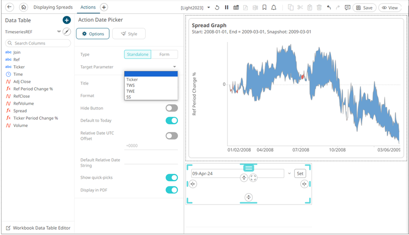

- After double-clicking or drawing a rectangle on the dashboard canvas, scroll to the bottom of the Part Types pane and select Action Date Picker
      The Action Date Picker pane is displayed, and the Action Date Picker part is added on the dashboard canvas with the current date and the Set button to the right.
For this example, the following parameters are defined:

These parameters are used on the Title of the Line graph (e.g., Start: {TWS: yyyy-MMM-dd HH:mm:ss}, End = {TWE: yyyy-MMM-dd HH:mm:ss}, Snapshot: {SS: yyyy-MMM-dd HH:mm:ss}).

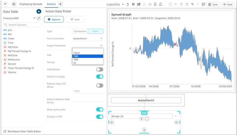

 - The action date picker can be configured to either be a Standalone or a Form component.
When set to Form, the action date picker can be be connected to any form controller on the same dashboard. The parameters that the action part can set depends on how the form is configured.
NOTE: An action form part must be defined first to associate the action date picker as a component. Refer to Adding an Action Form more information.
A line connects the component to the associated form.

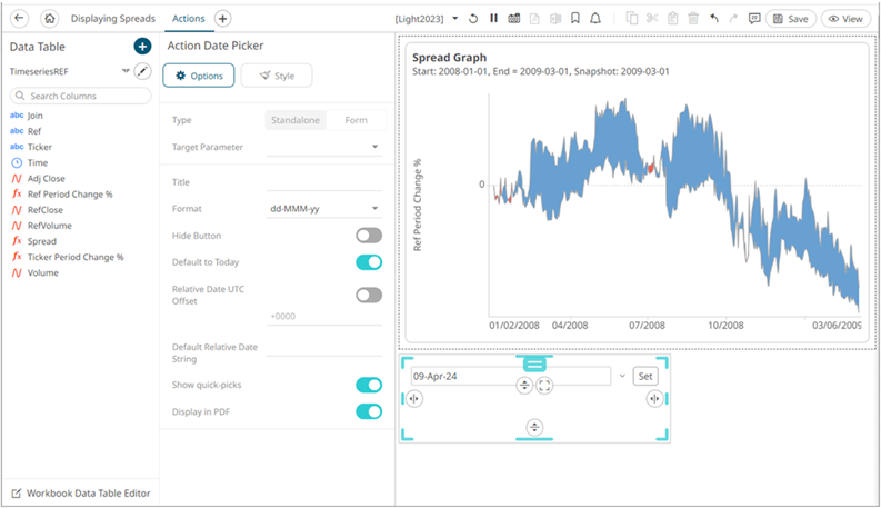

If the action date picker should not be connected to a form, it can be set to Standalone instead. Select the Target Parameter that will be updated by this action part.
Enter the Title of the action date picker button.

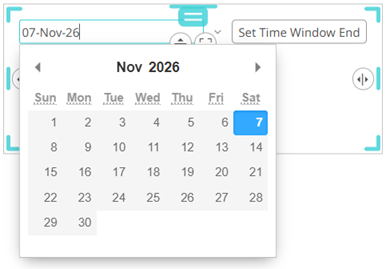

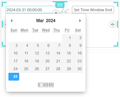

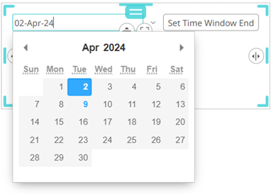

Selecting the Date/Time box displays the date picker in calendar mode.
The text of the date can be directly entered, or alternatively it can be clicked on, to bring up a date picker in the Web client.

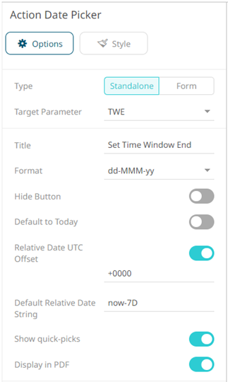

 - Tap the Relative Date UTC Offset slider to turn it on then enter the UTC Offset value (default is +0000).

 - Instead of turning the Default to Today slider on, enter the Default Relative Date String then click
. This allows the relative date calculation (based on today’s date), by parsing the input text string.

The date will be now-7D by default.
For example, now is April 9, it will go back 7 days (April 2) and then the date will be recalculated along with the Date/Time format.

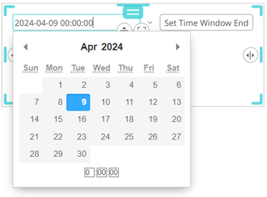

For example, if you enter now-5M-2D+3Y in the Action Date Picker Settings pane:
The date will be now-5M-2D+3Y by default.

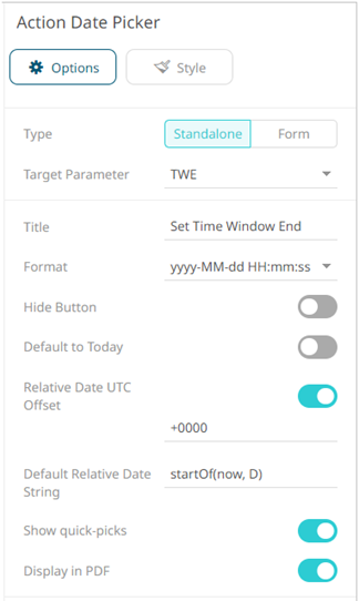

In the expression, you can also use startOf and endOf functions. Both functions take the same arguments, a relative time string, and a unit.
For example, if you enter startOf(now, D):
The date will display the start of the current day:

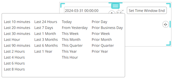

 - The Show quick-picks option is enabled by default. This allows you to select from pre-populated date ranges.
See to Selecting Relative Dates in Action Date Picker and Action Date Range Picker Controls for more information.
Tap the slider to turn off this option.
