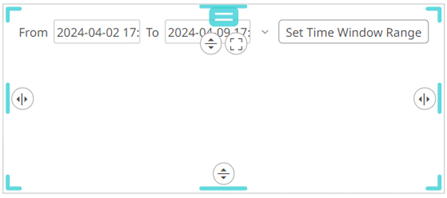

    The Action Date Range Picker pane is displayed, and the Action Date Range Picker part is added on the dashboard canvas with the current date range (parameters From Date to To Date) and the Set button.

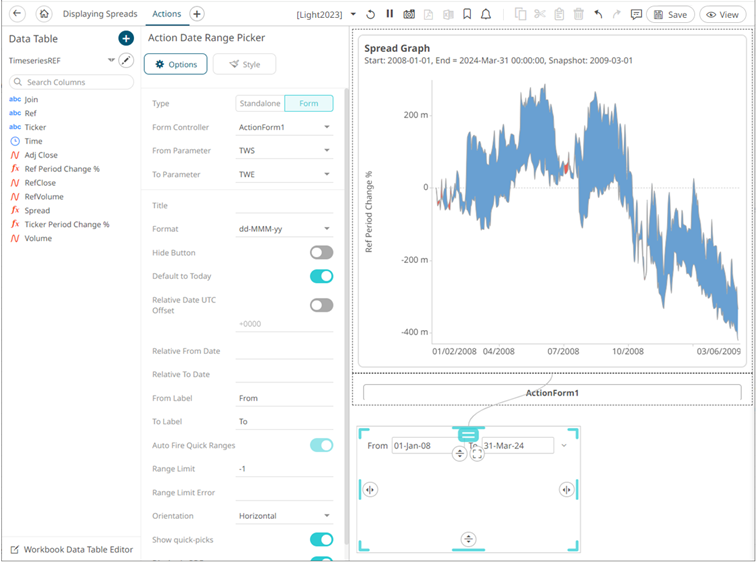

  2. The action date range picker can be configured to either be a Standalone or a Form component.
    When set to Form, the action date range picker can be be connected to any form controller on the same dashboard. The parameters that the action part can set depends on how the form is configured.
    NOTE: An action form part must be defined first to associate the action date range picker as a component. Refer to Adding an Action Form more information.
    A line connects the component to the associated form.

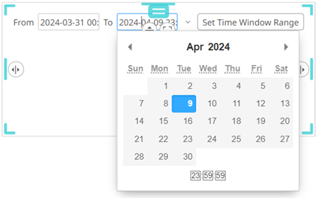

    Selecting the Date/Time box displays the date range picker in calendar mode.
    The text of the date can be directly entered, or alternatively it can be clicked on, to bring up a date picker in the Web client.

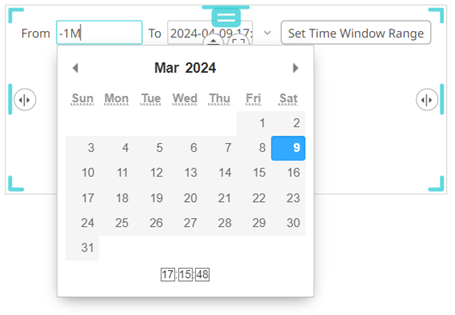

        For example, if you enter -1M:
        The recalculated relative date will be September 26:

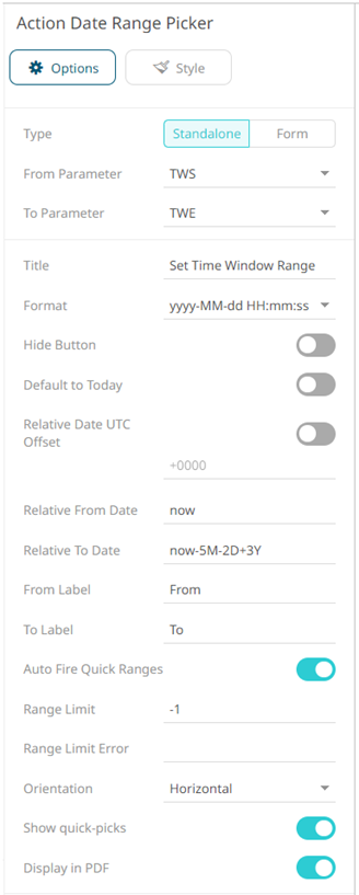

      For example, if you enter now-5M-2D+3Y as the Relative To Date and now as the Relative From Date:
      The date will be now-5M-2D+3Y by default.

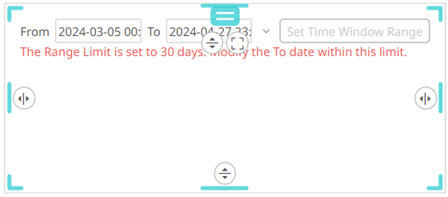

  12. When a Range Limit has been set, the Range Limit Error box is enabled. It is mandatory to enter an error message to help in defining a better input to match the set limit.
    For example: “The Range Limit is set to 30 days. Modify the To date within this limit.”
