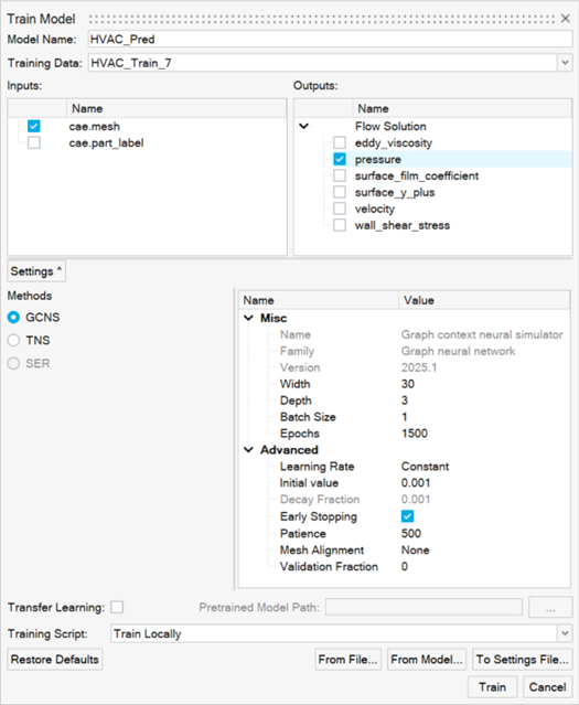

  2. Define the training details and click Train.
    1. Enter a model name.
    2. For Training Data, select the created or existing Train Dataset.
    3. Select Inputs and Outputs.
      Multiple responses can be selected for training.
    4. Select a Training Script.
      Note: Options to train using Altair One compute resources will appear when two requirements are met:
      • The project is saved to Altair One Drive.
      • At least one visible compute appliance in Altair One has an installed version of PhysicsAI that is consistent with the edge client version of PhysicsAI.
    5. Specify the hyperparameters of the training process, such as the number of epochs or learning rate.
      Tip: If desired, transfer learning can also be enabled.
      Transfer learning involves using the knowledge from an existing PhysicsAI model while training a new model. It can be beneficial in cases where too few data points are available for training a new model from scratch. To enable transfer learning, the new PhysicsAI model should have the exact same width, depth, and input features.
      Note: You can hover over the hyperparameter names to read their description.
      Hyperparameters will affect the quality of a trained model. The optimal set of hyperparameters will vary from problem to problem. Running experiments to the tune the hyperparameters to maximize model performance is an important last step in a complete PhysicsAI process.

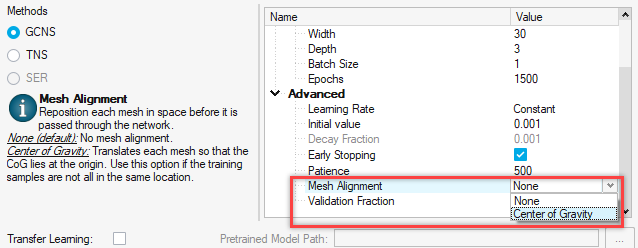

      PhysicsAI has three AI methods available for training: Graphical Context Neural Simulator (GCNS), which is the default option, Transformer Neural Simulator (TNS), and Shape Encoding Regressor (SER). For more details, refer to Frequently Asked Questions.
      Tip: For meshes which are translated in space, these can be realigned using the Mesh Alignment option during model training.

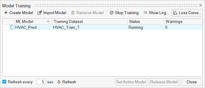

      The Model Training dialog opens.
  3. Review the status in the Status column.
    Tip: Once the status changes to Running, you can view the training logs by clicking Show Log.

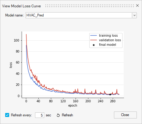

  4. Optional: Click Loss Curve to view the training of a validation loss curve.
    The curves are useful to visualize the progress of the training process. In a well fit model, the training and validation losses become nearly identical. If validation never approaches the training loss, this is indicative of underfitting;  increased training time can leave files d to improved model performance. A validation loss that approaches the training loss but diverges higher likely indicates overfitting; the point of low validation loss is the ideal model to avoid loss of generalization. For more information, see Best Practices for PhysicsAI.
    Note: The validation curve only appears if there are at least 15 samples.

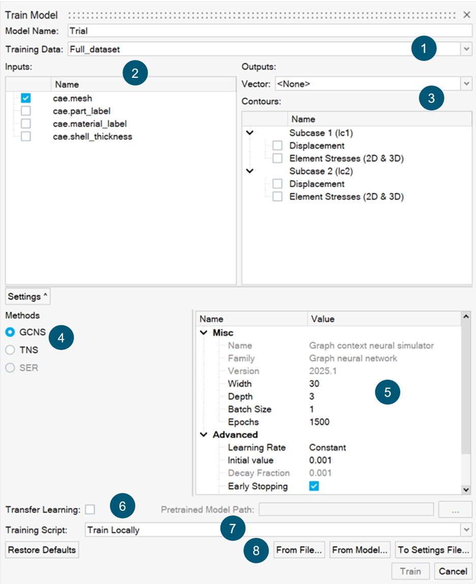

Navigate the Train Model GUI
Figure 9.
  1. Drop-down menu to select from available datasets.
  2. Inputs selection based on available inputs from the dataset. Both native and custom inputs are displayed here.
    Input Feature Description
    cae.coord Spatial coordinates used as a predictor of behavior. It is recommended to always keep it on.
    cae.part_label Part name is used as a predictor of behavior. This is valuable when working with large assemblies. In most cases, it is recommended to keep it on. However, it may make sense to turn it off in cases with inconsistent part names.
    cae.shell_thickness The thickness of 2D shell elements is used as a predictor of behavior. This is required when the dataset has varying thicknesses between simulation models. This feature is only available for supported solver decks (for a list of supported solver decks, see Frequently Asked Questions) and requires the selection of Extract Simulation Properties during dataset creation. Solver input files must be in the same directory as the associated output file and have the same basename.
    cae.material_label Material name is used as a predictor of behavior. This is required when the dataset has varied material assignments between simulation models. This feature is only available for supported solver decks (for a list of supported solver decks, see Frequently Asked Questions) and requires the selection of Extract Simulation Properties during dataset creation. Solver input files must be in the same directory as the associated output file and have the same basename.
  3. Outputs selection based on the possible outputs contained within the dataset. KPI and curve outputs are contained in a drop-down menu while field outputs are shown in a tree chart.
    When vector data is available, a vector prediction option displays under Outputs. Vector data is provided alongside the primary files selected during dataset creation. The vector data should have the same basename as the primary data file, but with a .json extension. An example of the .json schema is shown below:
            "label": "Scalar1",
            "type": "vector",
            "data": [
               0.5667
            "label": "List1",
            "type": "vector",
            "data": [
                0.00000,
                0.58778,
                0.95105,
                0.95105,
                0.58778,
                0.00000
  4. Architecture/method to be used for training. PhysicsAI has three architectures: Graph Context Neural Simulator (GCNS), Transformer Neural Simulator (TNS), and Shape Encoding Regressor (SER) (for KPI/curves predictions only, no field predictions). For more information on these architectures, see Frequently Asked Questions or Best Practices for PhysicsAI.
  5. Hyperparameters or training settings to be used. Five hyperparameters are common to all architectures: width, depth, batch size, epochs, and learning rate. Others are specific to each architecture. Click on the labels for a description and recommended values. For additional information refer to the Hyperparameters section and Best Practices for PhysicsAI.
  6. Transfer Learning enables the use of a previously trained PhysicsAI model as a starting point, effectively transferring the knowledge from the previously trained PhysicsAI model to the new PhysicsAI model which is being trained. To use transfer learning, the inputs must be the same as the previously trained model. For more information, see Best Practices for PhysicsAI.
  7. Training Script is for specifying the execution location for the training.
  8. The specifications toolbar can be used to read the hyperparameter, inputs, and output choices from an existing PhysicsAI configuration file (.pscfg) or a PhysicsAI model file (.psmdl). It can also be used to export the current settings as a configuration file (.pscfg). This feature is useful to ensure that settings can be kept consistent between different training rounds while eliminating errors from manual operations.
