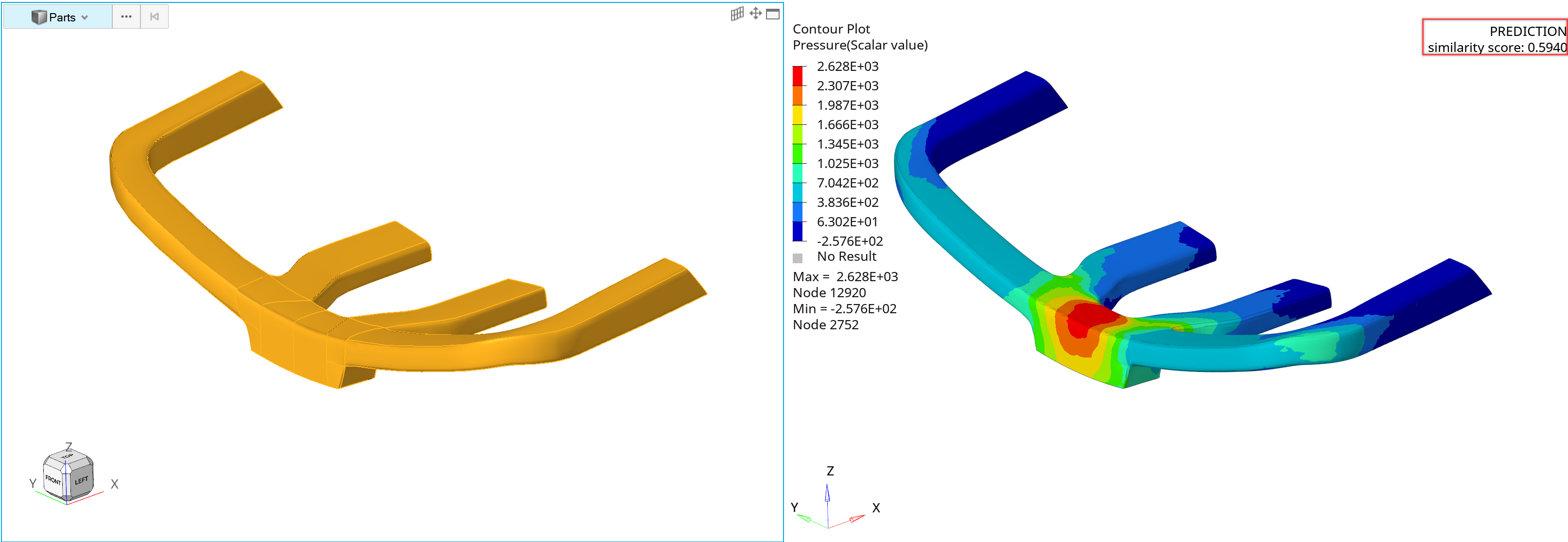

Similarity Score
Like all machine learning models, PhysicsAI models are most accurate when the design being predicted is similar to the designs used for training.

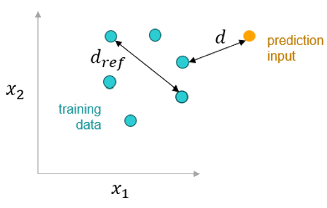

- 1.0
- Equivalent to training sample
- 0.0
- As far from the nearest training point as any two training points are from each other
- < 0.0
- Far from a training point

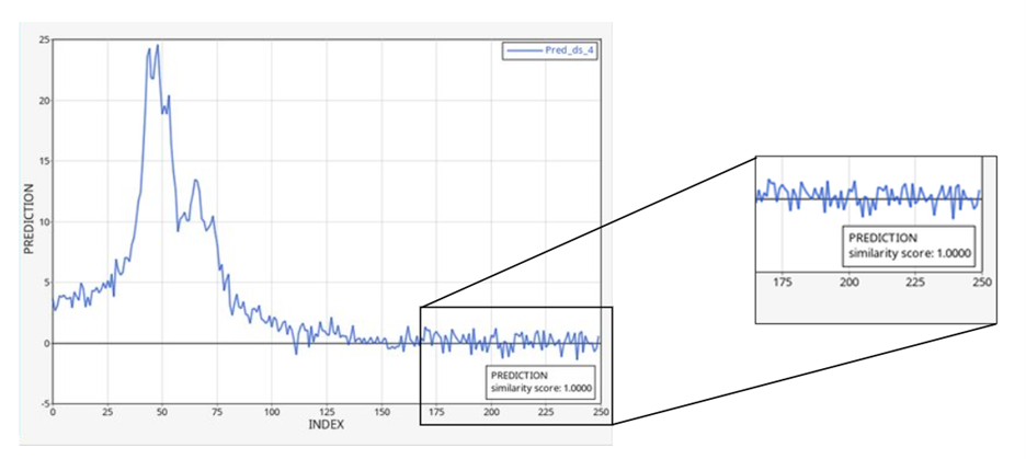

Interpret Similarity Scores
A similarity score of 1.0 indicates that the input design is the same as one of the training points. This is the maximum possible value.
A similarity score of 0.0 indicates that the input design is as different from the nearest training point as the two farthest training points.
A negative similarity score indicates that the input design is very different from the training data. It’s likely that the prediction will be low-quality unless a new model is trained with data sufficiently similar to the predicted designs.
