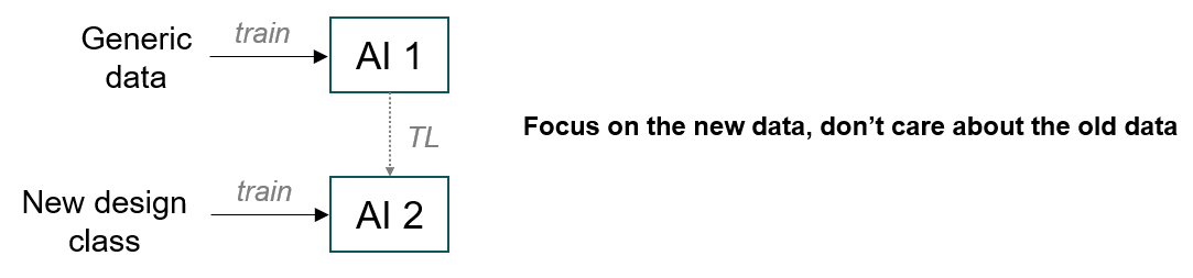

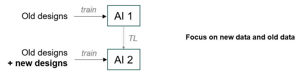

When should I use transfer learning?
Repurpose a PhysicsAI Model
Adapt a generic model for a new class of designs.
Update an Existing PhysicsAI Model
Use the old model and new data to create an improved model.
