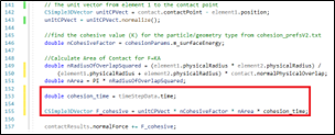

    3. Locate the F_cohesive vector in the source file as follows:
    4. Add the multiplying factor of the current simulation time to the F_cohesive calculation as follows:
      Create a new double called cohesion_time before the F_cohesive calculation and assign this as the value of the current simulation time:
    5. Add a limit of 0 - 3 s for the cohesion increase to take place and update the code as follows:
      Note: Multiplying by time causes an error where, after a large time has elapsed (60 s), the cohesion value will have increased accordingly, and could be unexpectedly high as the cohesive force increase does not have any limitations.
