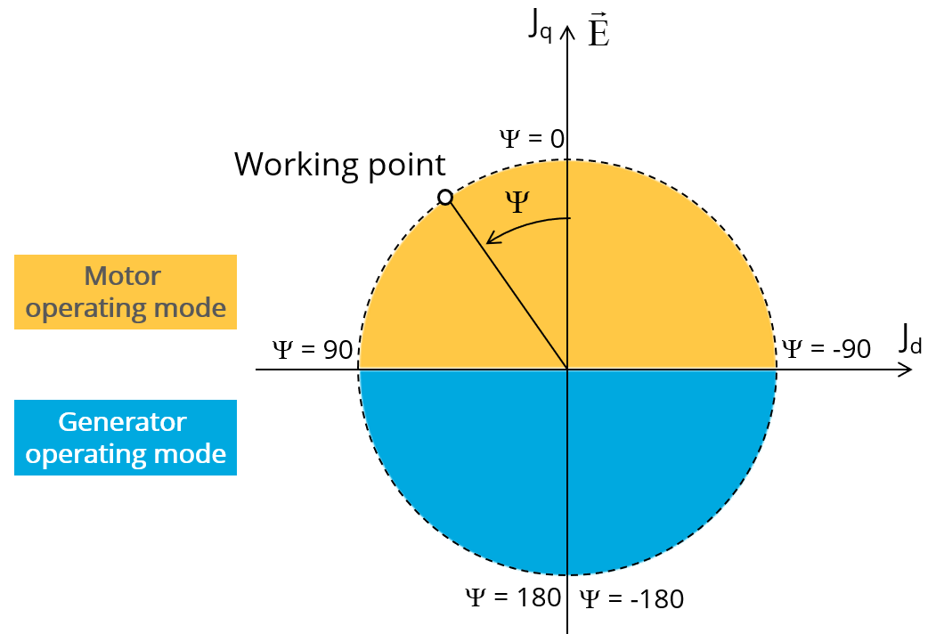

  2. Control angle
    Considering the vector diagram shown below, the “ Control angle ” is the angle between the electromotive force E and the electrical current (J) (Ψ = (E, J)).
    It is an electrical angle. The default value is 45 degrees. It must be set in a range of -90 to 90 degrees.
    This range of values covers all the possible working point in motor convention.
    Definition of the control angle Ψ - Motor convention
