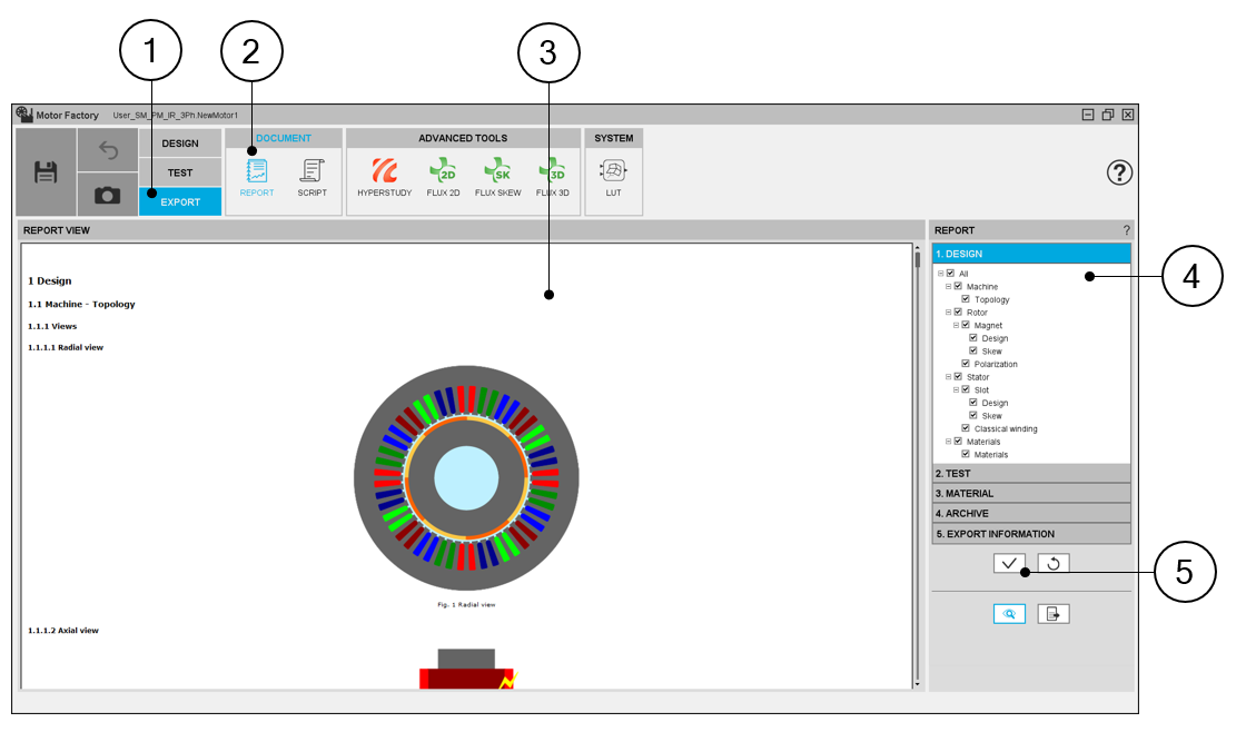

Motor Factory – EXPORT AREA – Export a report | |
1 | Selection of the EXPORT area of Motor Factory. |
2 | Access the area in which a report can be made |
3 | Zone to visualize the report (= preview) |
4 | 4 steps to build the report which user need |
5 | Buttons to validate inputs, display a preview and export a report |
