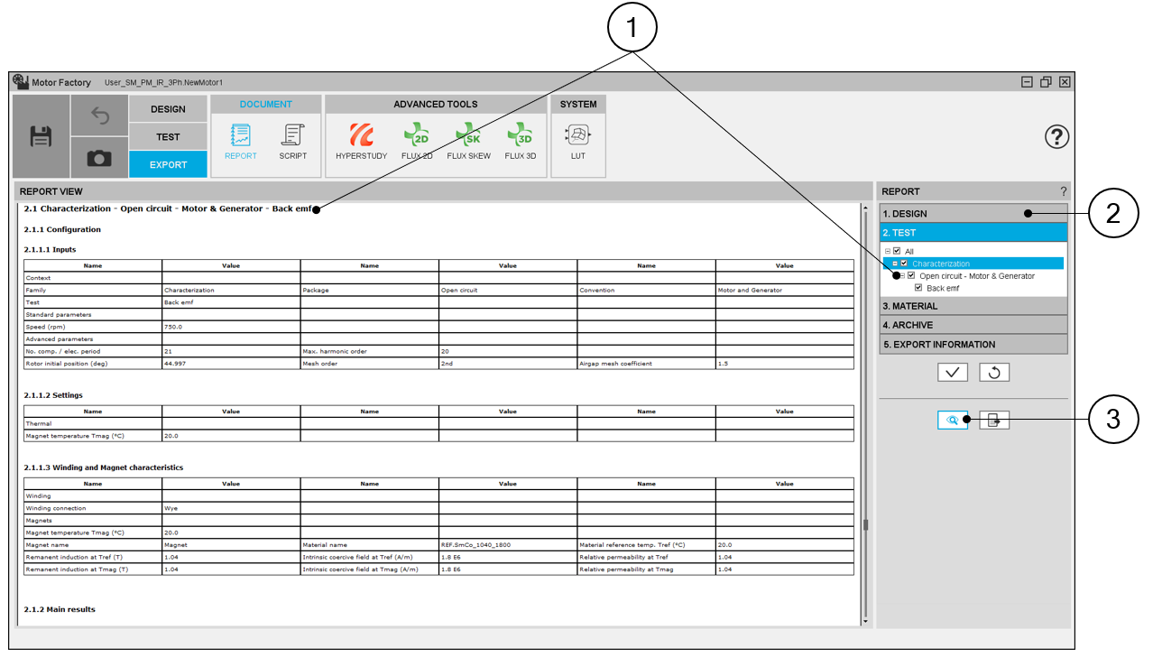

2. Selection of sections
| Motor Factory - EXPORT AREA – Export a report – Chapters to be selected | |
| 1 | Section names are shortcuts for displaying the corresponding section of the report |
| 2 | Check the section to add chapters to the report |
| 3 | Button “Preview” considers the selected chapters and displays the report |
