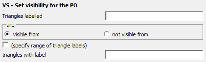

Figure 1. The VS - Set visibility for the PO dialog.
To accurately compute multiple reflections Feko needs to determine which basis functions are visible to each other. Since this applies to all the PO triangles it may be very time consuming for large problems. The time required to determine the visibility may be greatly reduced if the user can specify which triangles are visible or hidden from each other.
Parameters:
- Triangles labelled
- The label of the source triangles.
- are visible from
- All triangles with the label specified in the field Triangles labelled are visible from all triangles with label(s) indicated in the fields below.
- are not visible from
- All triangles with the label specified in the field Triangles labelled are not visible from all triangles with label(s) indicated in the fields below.
- (specify range of labels)
- If this item is unchecked, only a single label is specified (in triangles with label). If checked, the card applies to all triangles with labels in the range from the value specified in triangles with label to those in to triangles with label.
Basis functions cannot illuminate each other if all the triangles they are attached to lie in the same plane.
The VS card should only be used if the user can specify the visibility beyond any doubt and if it applies to all triangles of that label. If no information is specified for a specific combination of labels/triangles, full ray tracing will be executed.
