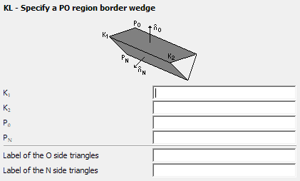

Figure 1. The KL card - Specify a PO region border wedge dialog.
Parameters:
- K1
- The start point of the axis of the cone (the centre of the base).
- K2
- The end point of the axis (the tip of the cone, or the centre point of the circle when creating a conical section).
- P0
- A point on the O side of the wedge.
- PN
- A point on the N side of the wedge.
- Label of the O side triangles
- The label of the PO triangles that are adjacent to the wedge on the O side. This means that the corresponding correction term for the O side is assigned to the PO triangles that have this label.
- Label of the N side triangles
- The label of the PO triangles that are adjacent to the wedge on the N side. This means that the corresponding correction term for the N side is assigned to the PO triangles that have this label.
