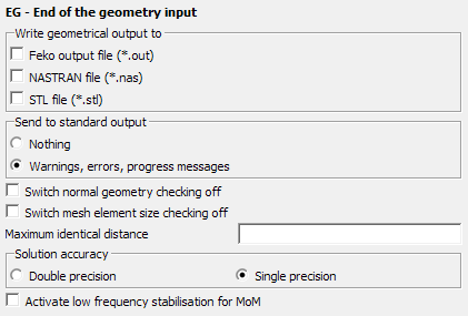

The EG card indicates the end of the geometrical input. It is essential that the EG card is used.
On the Home tab, in the Structure group,
click the
End geometry (EG) icon.
Figure 1. The EG - End of the geometry input dialog
Parameters:
- Write geometrical output to
- The geometry data of the segments and surface elements can be written to the Feko output file, a NASTRAN format file, an STL file, or any combination thereof. The name of the NASTRAN or STL file will be the same as the Feko model, but with a .nas or .stl extension. Writing the geometry data to the output file may lead to huge output files.
- Send to standard output
- If the field Nothing is selected, no messages are sent to the standard output device (usually the screen). If the item Warnings, errors, progress messages is selected, warnings, errors and messages that indicate the program’s progress are sent to the standard output device.
- Switch normal geometry checking off
- If this item is checked, the verification of the geometry elements Feko will be switched off (see the discussion below this table).
- Switch mesh element size checking off
- If this item is checked, the verification of the mesh elements size in relation to the frequency will be switched off
- Solution accuracy
- This parameter can be set to force Feko to use single precision for the storage of the memory critical arrays. Single precision storage is the default behaviour, and as compared to double precision the memory requirement is then half. Using double precision is recommended when the Feko kernel gives a warning to switch to double precision (this might happen for instance at low frequencies where an increased accuracy is required).
- Activate low frequency stabilisation for MoM
At very low frequencies (frequency range where the largest dimension of the model is much smaller than a wavelength), the method of moments (MoM) solution can become numerically unstable and singular.
The default MoM solution uses single precision. When using double precision, the MoM solution is valid for lower frequencies than for single precision. If the solver gives a warning about the matrix stability when using double precision, then it is recommended to use low-frequency stabilisation.
If this item is selected, low frequency stabilisation for MoM is activated.Note: Low-frequency stabilisation is not required at higher frequencies and increases the runtime. Double precision uses double the memory of single precision.- Auto
- The Solver determines automatically if low frequency stabilisation should be used for the model.
- Always on
- Enable low frequency stabilisation for the model.
