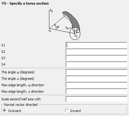

TO Card
Using the TO card a surface mesh in the form of a toroidal segment can be generated.
On the Construct tab, in the Surfaces group,
click the
Torus (TO) icon.
Figure 1. The Specify a torus section dialog.
Parameters:
- S1
- The centre of the toroid.
- S2
- A point that is perpendicular and is situated an arbitrary distance above the plane of the toroid.
- S3
- The start point of the axis of the toroid.
- S4
- A point on the surface of the toroidal segment. It must be in the plane S2–S1– S3.
- The angle (degrees)
- The angle of rotation around the axis S1–S2.
- The angle of rotation around the axis of the toroid, see the figure displayed in the card.
- Max edge length, direction
- The maximum edge length along the curved edge in the direction in m (is scaled by the SF card). If this parameter is left empty, the value specified with the IP card is used.
- Normal vector directed
- The triangles can be created so that the normal vectors point Outward (outward, away the ring axis of the toroid) or Inward.
- Scale second half axis with
- If this parameter is empty or is set to 1, a toroid with a circular cross section is created. If set to , an elliptical toroid is created by distorting the entire geometry along the second half axis (orthogonal to the axis S1–S3) with the factor where a is the distance S1–S3. It is not recommended to generate toroids where the elliptical cross section has extremely small or extremely large axial ratios with a CAD system (such as FEMAP) as the distortion formulation used in PREFEKO may fail in these cases.
A complete toroid is obtained by using the parameters and .
