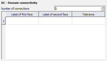

Figure 1. The DC - Domain connectivity dialog.
Parameters:
- Number of connections
- Specify the number of connections for the two meshes.
- Label of first/second face
- Define for each connection, the labels of the corresponding faces.
- Tolerance
- Define for each connection point, a tolerance distance to distinguish between regions, where a gap in the model is desired (or not desired).
