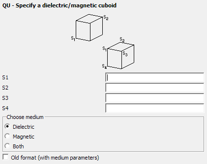

Figure 1. The QU - Specify a dielectric/magnetic cuboid dialog.

Parameters:
- S1
- First corner of the cuboid.
- S2
- Opposite corner of the cuboid if aligned with the principal planes, otherwise one of the corners adjacent to the first corner.
- S3
- Optional third corner of the cuboid, adjacent to the first.
- S4
- Optional fourth corner of the cuboid, adjacent to the first.
- Choose the medium
- Select here whether the cuboid is Dielectric or Magnetic or Both (this is always with respect to the environment, if the relative permittivity of the cuboid material differs from the environment, then this is a dielectric cuboid).
