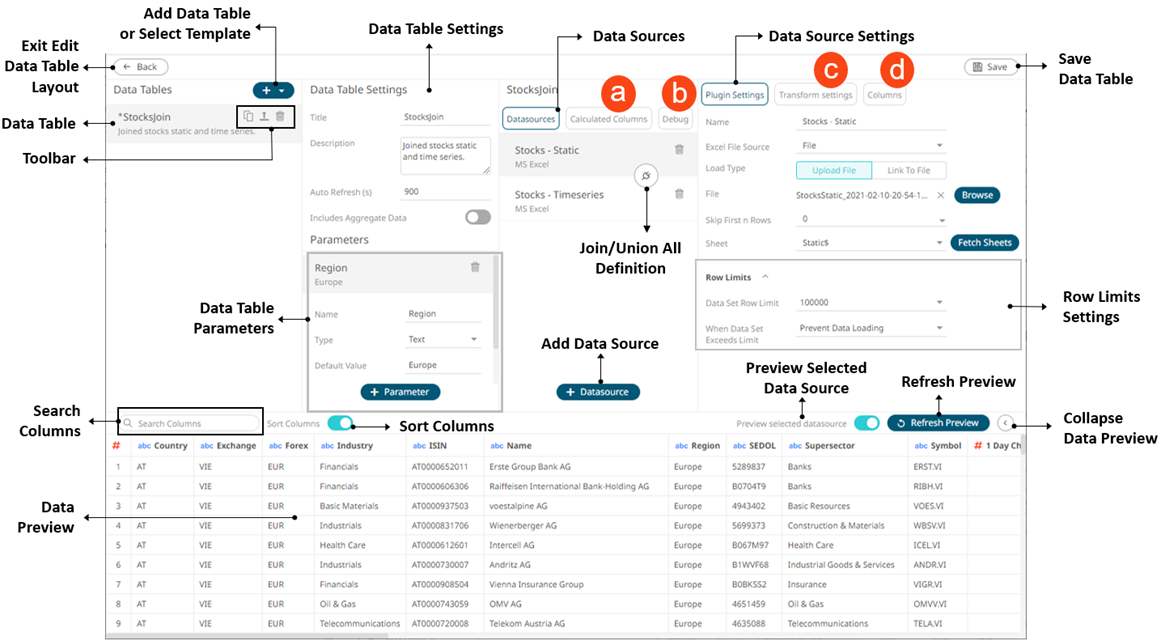

The Edit Data Table layout is displayed as below, wherein in this example, there are joined data sources:
Property |
Description |
Back |
Exit the Edit Data Table view and go to the Open Workbook in Design Mode view. |
Data Table |
List of data tables. Can be rearranged. |
Toolbar |
After the data is successfully retrieved, three options on the Edit Data Table layout allows: · Making a duplicate of the data table · Publishing the data table template · Deleting the data table |
Search Columns |
Allows searching of columns on the Data Sources Preview. |
Data Preview |
Executes the queries to return and display data. |
Add Data Table or Select Data Template |
Add data table or select a data table template. |
Data Table Settings |
Definition of the name of the selected data table, description, and the auto refresh period (in seconds). Also allows the retrieval of external aggregates. |
Data Table Parameters |
Add or manage data table parameters. |
Sort Columns |
Sort columns alphabetically based on type. If disabled, the columns are sorted based on how they are displayed on the data source. |
Data Sources |
One or more data sources that can be connected to directly, with data retrieved on the fly as it is required. Can be rearranged. |
Join/Union All Definition |
Allows definition of a join or union all of multiple data sources. |
Add Data Source |
Allows adding data sources from the available data connectors. |
Data Source Settings |
Displays the data source settings and allows for limiting the amount of data to be returned. |
Save Data Table |
Save the data table definition and go to the Open Workbook in Design Mode view. |
Row Limits Settings |
Allows setting of the row limit of data sources. |
Preview Selected Data Source |
Preview the selected data source on the Data Preview pane. |
Refresh Preview |
Refresh the data sources preview. |

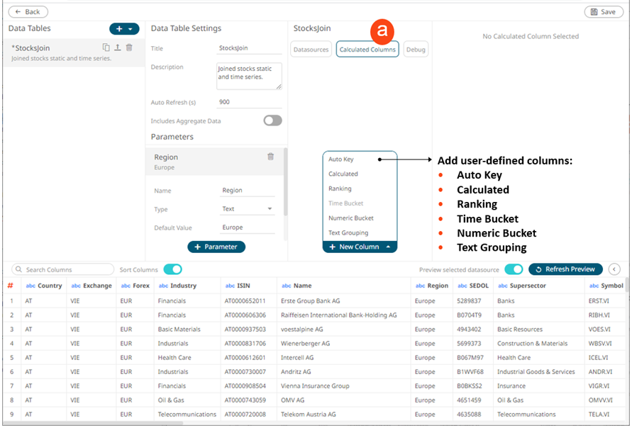

Clicking Calculated
Columns
displays
the New Column list box.
Property |
Description |
Add Auto Key |
Allow creation of an auto key for the data schema on the Data Sources Preview. |
Add New Calculated Column |
Allows creation of a calculated column from the existing columns in the data table. |
Add New Ranking Column |
Allows creation of a new numeric column based on the ranking of columns in your data. |
Add New Time Bucket Column |
Allows creation of time buckets (categorical time analysis). |
Add New Numeric Bucket Column |
Allows creation of Identity, Sign, Manual, Equal Density, and Equal Distance columns. |
Add New Text Grouping |
Allows creation of a grouping based on source text column. |

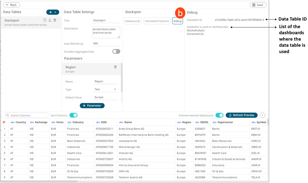

Clicking Debug
displays the Debug
pane.
Property |
Description |
Datatable Id |
Id of the data table. Can be used for parsing of server logs. |
Datatable is used on dashboard(s) |
List of dashboards where the data table is used. If a data table is not used, it can be deleted. |

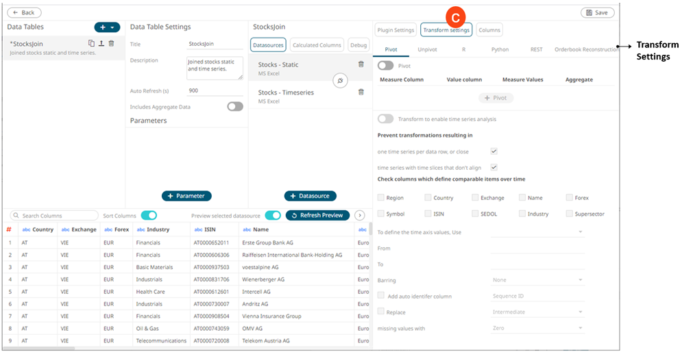

Clicking Transform
Settings
displays
the Transform Settings pane.
Property |
Description |
Transform Settings |
Allows you to perform the following: · pivoting or unpivoting retrieved data · transforming data to enable time series analysis including interpolation · running an R or Python script for data transformation · lists of orders to be reconstructed into an Order Book and conflated for output display |

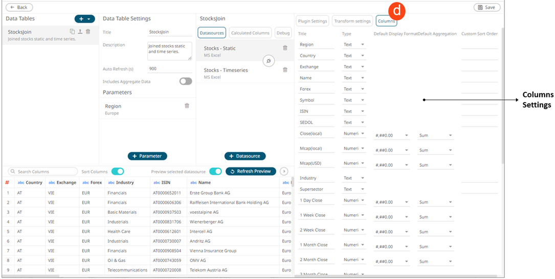

Clicking Columns
displays
the Columns Settings pane.
Property |
Description |
Columns Settings |
Allows you to perform the following: · view the column data type · rename the column names · select the numeric or Date/Time format · select the numeric default aggregation |
