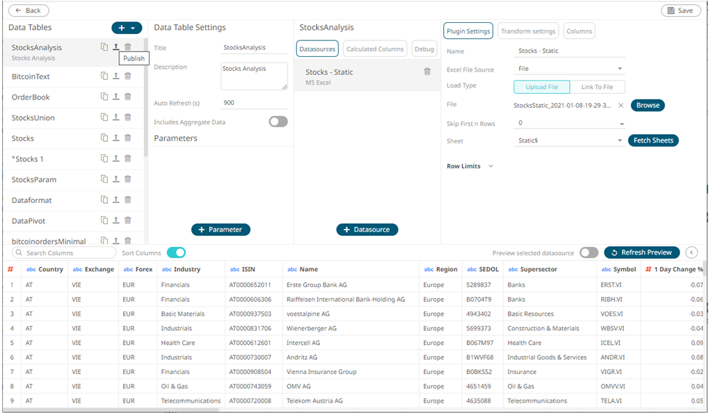

1.     Click the Upload Data Table  button of a data table in the Data Tables list.
The Publish Datatable dialog displays.

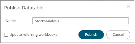

2.     You can opt to enter a new Name of the published data table template.
3.     Check the Update Referring Workbooks box to update the workbooks using the data table.
4.     Click .
An error message displays if an existing data table with the same name is already available.
Enter another name and click . The published notification message displays.
The published data table template is added on the Data Templates list and can be used when creating other workbooks.
