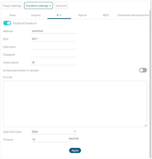

When the R button is selected, the Transform Settings pane changes to show:
1. Tap the Enable R Transform slider to turn it on.
The
Transform Settings button and R tab change to
and
, respectively.
The default Address (i.e., localhost) and Port (i.e., 6311) fields are displayed.
2. Specify the Username and Password if authentication is enabled on the Rserve process.
NOTE |
The Address, Port, Username, and Password fields will be hidden if their corresponding properties are set in the Panopticon.properties file.
3. The Frame Name that Panopticon will produce, and then be utilized by the R scripts should be specified. Default is df.
4. Enter the R Script. This R script should reference the input frame name and return a data frame. Just like an underlying SQL query, the R Script itself can be parameterized.

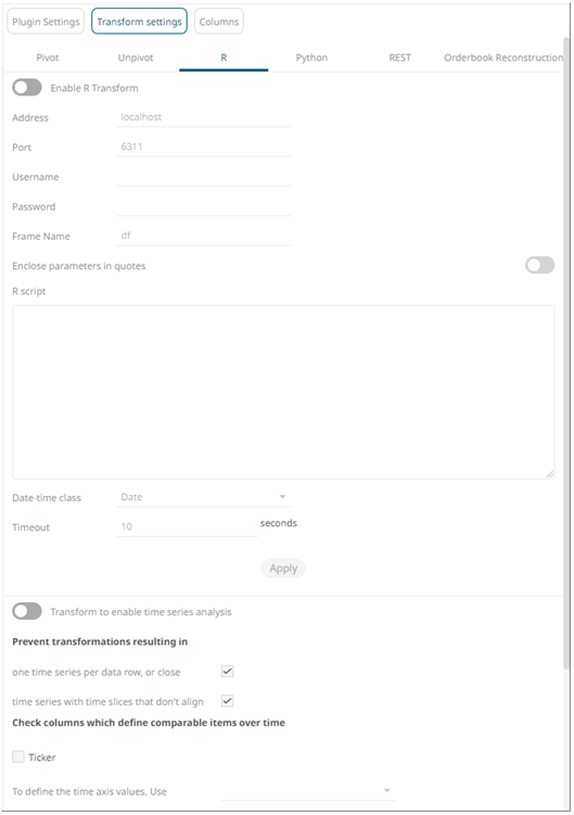

8. Click
. This prepares the time series analysis.
9. Refer to Enable Time Series Analysis for more information in enabling this feature.
