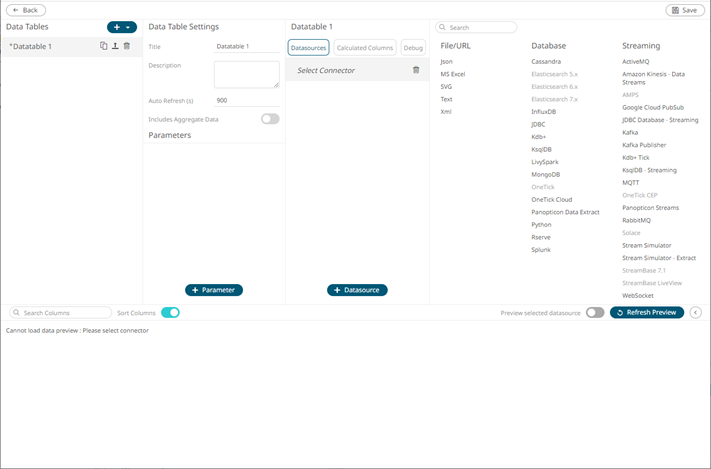

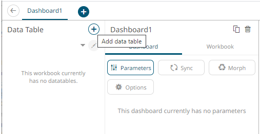

1. On the Data Table pane, click
The Edit Data Table view displays.
A new data table instance is created (Datatable 1).
In the Connector List pane, some connectors require additional third-party software installation to be enabled. This typically requires adding JAR files to the Libfolder of the Tomcat installation and restarting Tomcat. For the supported Elasticsearch connectors, refer to the Elasticsearch Connectors Dependency Installation section. For the other connectors, refer to the Panopticon Visualization Server Installation and Reference Guide for more information.

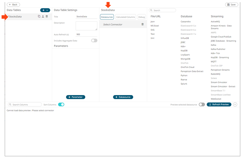

2. On the Data Table Settings pane,
enter the Title of the data table and click
. The new name is applied to the data
table under the Data Tables pane and on the Data Sources
pane.
3. Enter the Description of the data table.
This is also displayed under the data table instance which can be helpful when selecting among the data tables in the list.

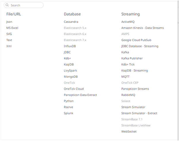

5. Click a data connector in the Connectors list.
Refer to Data Connectors for more information on the data connector you want to use.

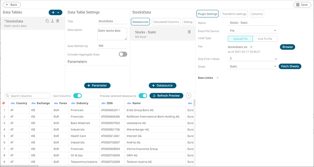

6. Tap the Preview Selected Data Source slider to turn it on and display the preview of the selected data source.
7. Then, you can either click:
for static connectors
for streaming connectors

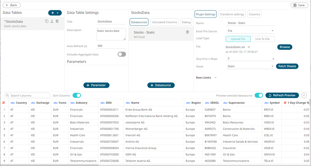

The retrieved query/table/sheet/schema is displayed in the Data Sources pane. The system displays the preview data at the bottom of the screen.
Click
to collapse the Data Preview
pane.
Click
to expand the Data Preview
pane.

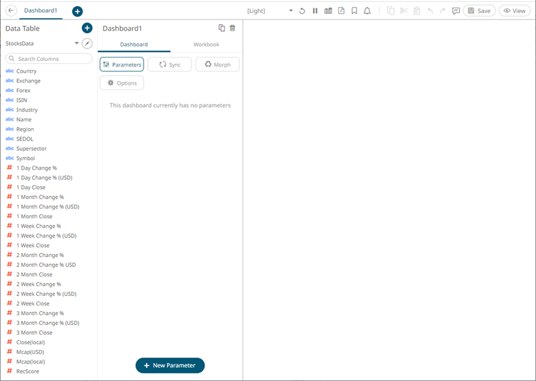

10. Click
. You are returned to the Open Workbook in Design Mode, with the new data table added in the
Data Table pane drop-down list.
