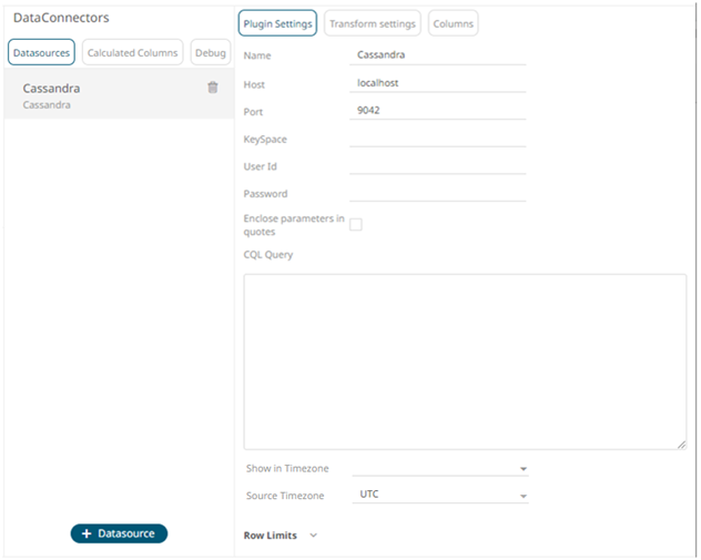

1. Select Cassandra from the Data Sources pane. The Cassandra Settings pane and the retrieved Cassandra source are displayed.
2. Enter the following information:

3. Select whether the parameters should be automatically enclosed in quotes, by checking the Enclose parameters in quotes box.
4. Enter the CQL Query, which can contain parameters in a similar manner to the database connector.
