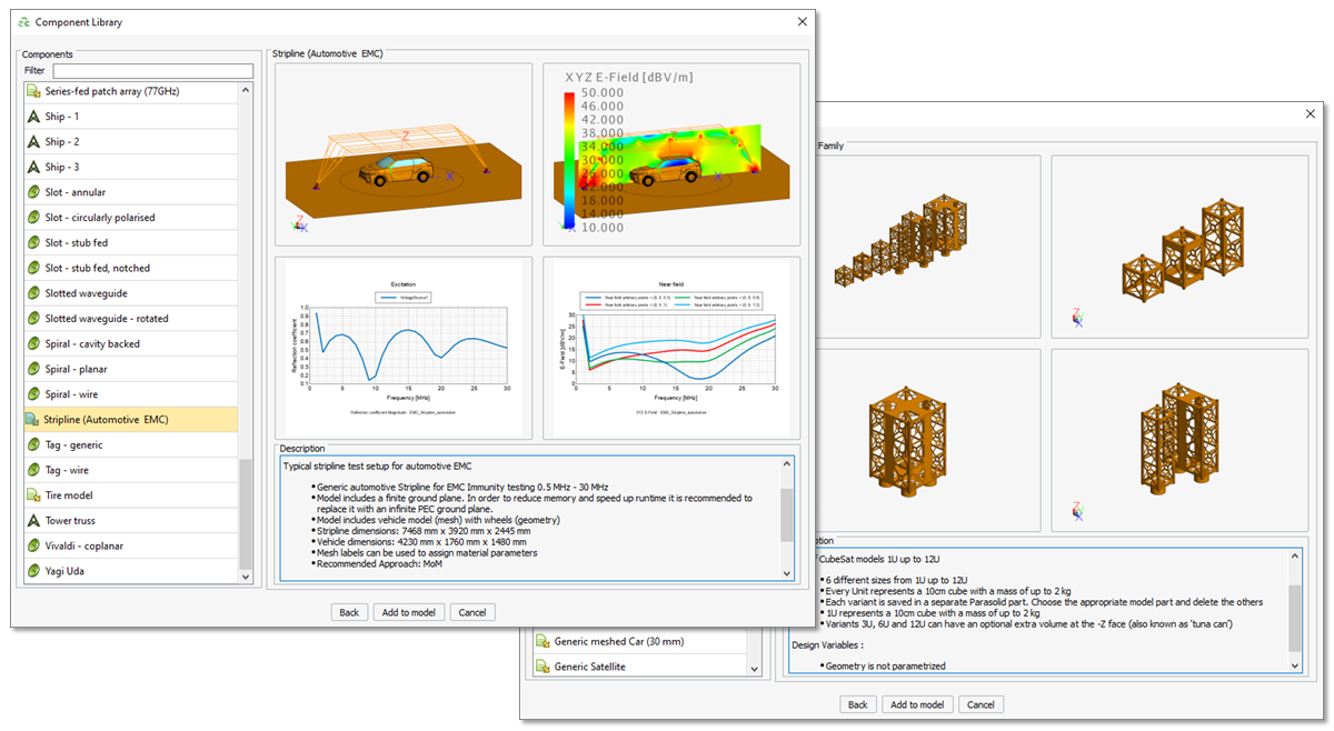

- A selection of new components was added to the CADFEKO component library. Ten new antenna models (including antennas for EMC testing) and four new platform models were added.

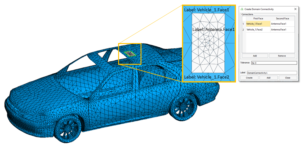

- A new domain connectivity approach allows meshes of specific parts to be treated as if “connected” during MoM and MoM/MLFMM solutions in places where the borders of the meshes are close together, even if the mesh vertices on those borders are not coincident. Domain connectivity can now be configured in CADFEKO (new in 2023) or EDITFEKO (since 2022.3) and visualized in POSTFEKO (new in 2023).

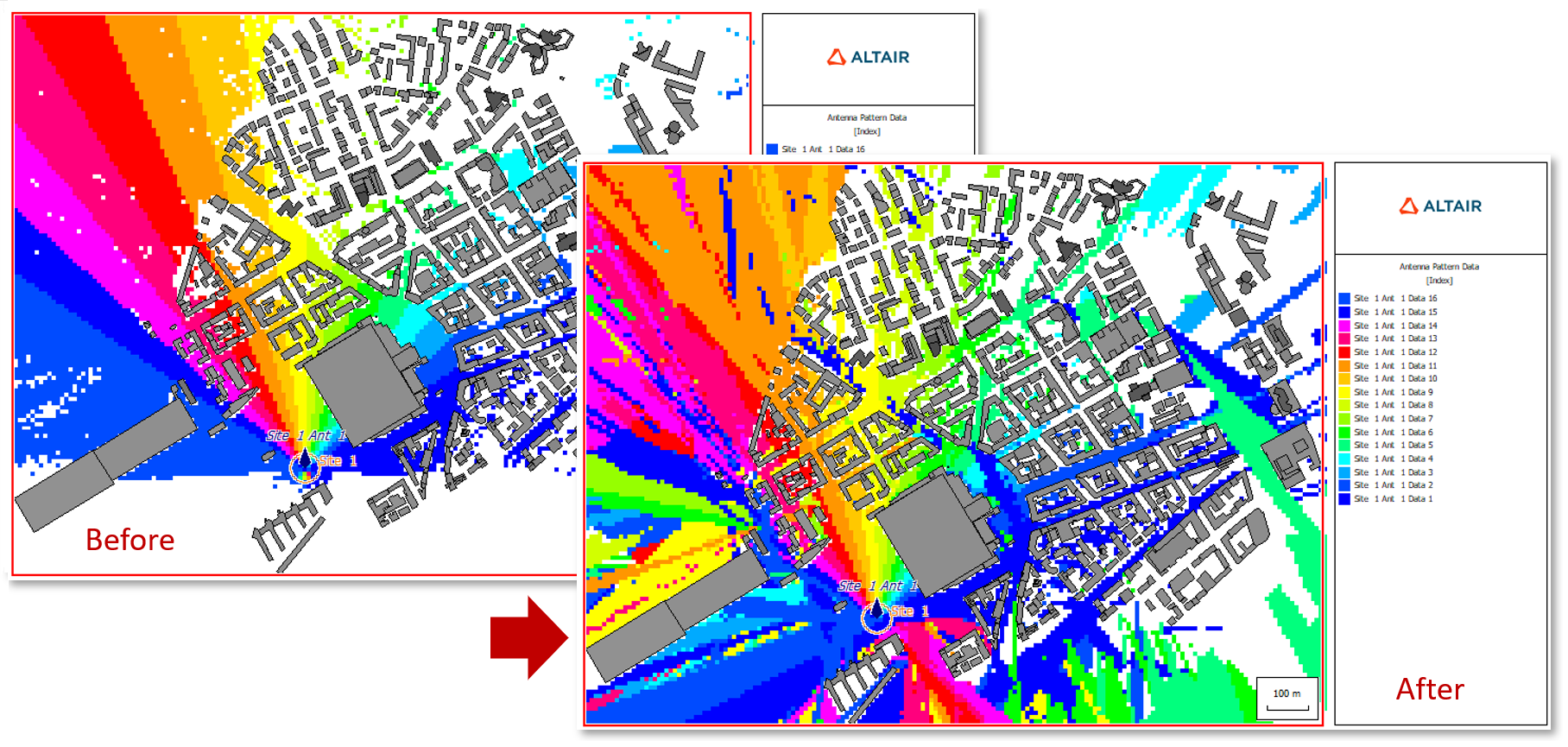

- Modified the beam assignment algorithm to use the rays of the receiving pixel leading to more accurate results.

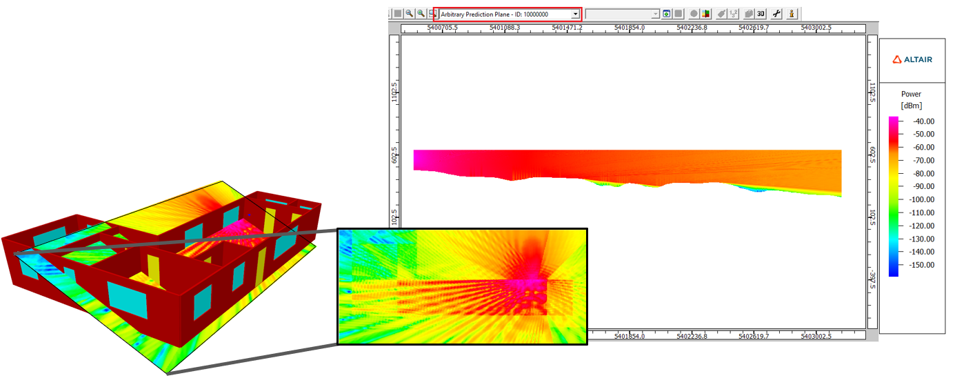

- Arbitrary prediction planes can now be viewed in the 2D view by selecting the plane from the prediction plane drop-down list. In the past, arbitrary prediction planes could only be viewed in the 3D view. This option is useful when viewing vertical planes of the Parabolic Equation (PE) model.

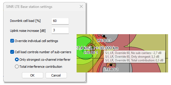

- Added support to calculate the LTE sub-carrier interference between neighbouring co-channel LTE base stations. The user has the option to select the strongest co-channel interference only, or all interference, in addition to defining the cell load. The option is used when LTE transmitters exist in coverage calculations that make use of interference, for example, RSSI, RSRQ, Data rate, Throughput, SINR.

- Added support to configure domain connectivity.

- Various models have been added to the component library. When using these components, design or configuration options that are available with other component library models are not shown, but rather a preconfigured model is imported into the open project. The user may then adjust variables and settings as needed.
- A model of a biconical/log hybrid (bilog) antenna for EMC immunity testing was added to the component library.
- A model of a horn antenna for EMC immunity testing was added to the component library.
- A model of a log periodic antenna for EMC immunity testing was added to the component library.
- A model of a stripline antenna for EMC immunity testing was added to the component library.
- A model of a reflectarray was added to the component library.
- A model of a generic satellite was added to the component library.
- A model of an open boundary quad-ridged horn antenna was added to the component library.
- A model of a two-by-two corporate feed patch antenna array at 5.7 GHz was added to the component library.
- A model of a square-shaped miniature satellite (CubeSat) was added to the component library.
- A model of a base station sector antenna was added to the component library.
- A model of a series-fed patch array for 77 GHz advanced driver assistance systems (ADAS) radar was added to the component library.
- Models of a generic car and tyres were added to the component library.

- Added rendering support for domain connectivity.

- Added support to view arbitrary prediction planes in the 2D view. The display of the pixel center and pixel grid can be enabled on the Default Settings dialog (Display tab).

- Added support for calculating LTE sub-carrier interference between neighbouring co-channel LTE base stations in the Coverage tool.
