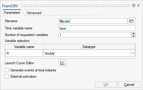

The block will read as many columns as specified by the first parameter (Number of requested variables). The columns are identified by their name (located on the first line, passed as a string).
If the block is activated by external activation and time stamp is also defined, the output are displayed at event activation times. The external activation may be turned off, if time instants are provided.
FromCSV_0
fname
Filename
Defines the name (path and full name, in between quotes) of the input .csv file.
independent
Time variable name
The column name that is an independent variable (usually time). If left empty, no time is used and an external activation is required.
nout
Number of variables to read in the .csv file. One variable corresponds to one column.
outports
Variable selection
Structure
outports/varname
Variable name
Name of the variable to read. String corresponding to the column name (first line).
Cell of strings
outports/vardatatype
Datatype
Cell of strings
'double'
'int32'
'int16'
'int8'
'uint32'
'uint16'
'uint8'
'boolean'
outevent
Generate events at time instants
Specifies if the block generates an activation event. When OutEvent is used, an additional event output port is added to the block. Default is off.
externalActivation
External activation

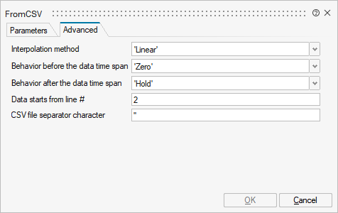

Method
Interpolation method
Defines how to interpolate the data that is read in from the .csv file.
'ZeroOrder(floor)'
'ZeroOrder(ceil)'
'ZeroOrder(nearest)'
'Linear'
'Not_a_knot'
'Natural'
'Clamped_To_Zero'
'Akima'
'Fritsch_Butland'
'Steffen'
Leftside
Behavior before the data time span
'Zero'
'Hold'
'Extrapolation'
'Repeat'
'Error'
Rightside
Behavior after the data time span
'Zero'
'Hold'
'Extrapolation'
'Repeat'
'Error'
Offset
Data starts from line #
Line from which to start reading the .csv file. Default is 2.
Separator
CSV file separator character
Enter a separator character in this field. If the field is left empty, the default separator is the first character that follows the variable time in the first line of the .csv file.
