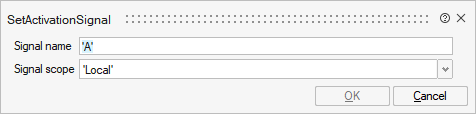

The "Signal Scope" parameter defines the scope in which the implicit signal is defined. For more information, please refer to the GetSignal block.

tag
Signal name
Signal name.
tagvis
Signal scope
Scope of the given signal. Default: local.
'Local'
'Scoped'
'Global'
