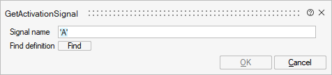

GetActivationSignal
This block receives input activations from a corresponding SetActivationSignal block by connecting the event ports of the blocks without using a link. A single SetActivationSignal block can send activations to multiple GetActivationSignal blocks, but a GetActivationSignal block can receive activation from only one SetActivationSignal block.
Activate/Routing
The GetActivationSignal connects event ports from one block to another without connecting them physically. It is used with a SetActivationSignal block. A simple SetActivationSignal block can send activation to multiple GetActivationSignal, although a GetActivationSignal can receive activation from only one SetActivationSignal. SetActivationSignal transports its input activation to its corresponding GetActivationSignal block.
For more information, please refer to the GetSignal block.Parameters
tag | Signal name | Signal name. | String |
Port 1 | activation | output | 1 |
